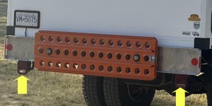

That looks pretty good but why have the track mates hanging down like that? They look like an after thought.
Fair question! Eventually, there will be a storage box filling the empty space with the recovery boards mounted at the same place. Much easier to grab them from there then from any other place around the truck. Like with everything else on a project like this it takes time, money and patience to bring it to completion. 🤙
