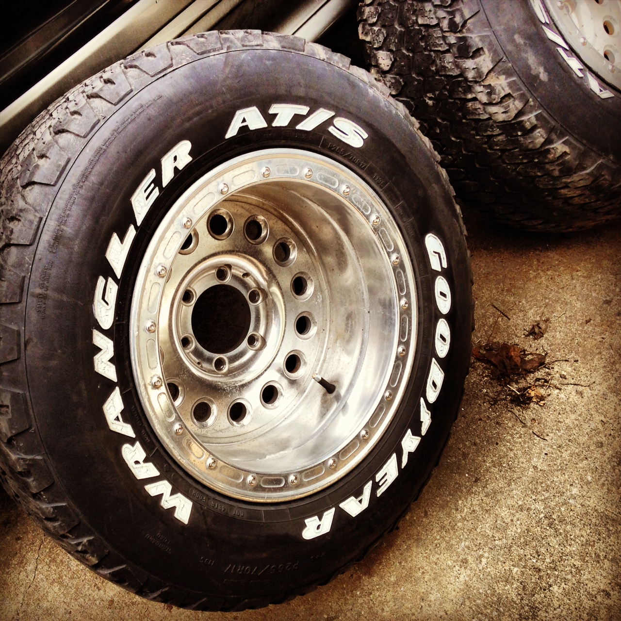

17x10, currently on my daily driver i have 15x10 with 35's, stock suspension, mild trim, i can turn full lock right now, we'll see :)
Carlos AKA Cap510 (on here on on the 'wire) is running 37's and can turn full lock. here's an animated gif of him on the trail...

17x10 wheels I got today, with alright condition 32's, they're the same offset as my 15x10's and sit right at the edge of the flares.
