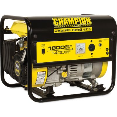

HF extended their Black Friday sale for a week, and the little 2-stroke was on sale for $88. Plus they sent me another 20% off coupon. Thought abought it, but no.
Before the HF gens, I had a Champion Power Equipment 1200w/1500w 4-stroke that I really liked a lot. I looked into getting another some time ago, when the first HF failed. I discovered that they had a new model - 1400w/1800w. It looked to have the same 80cc engine, but a higher power rating. So I called and asked them about it. I was told that model had a beefed up alternator.
I looked around and the only place that carried it was Tractor Supply - and not all stores carried it. The closest one that had one was two hours away. Each direction. Meh. I could have ordered it delivered, but they were asking $260 for it, plus tax and shipping. I could have gotten another 1200 off Amazon for $199 with no tax and free shipping. So I was wondering if it was worth it. Ultimately, I was in a hurry to get out of town so I just picked up another HF 2-stroke.
So when that one failed this morning, I decided to just sit around drinking coffee and catching up on Mr. Robot. :D
But I did some web surfing and lo and behold - TSC still carries the 1400w Champ. For $199. And a couple stores have them in stock, including one about an hour away. So after I think it over (procrastinate), I'll probably make a pilgrammage to TSC and get one.
I wonder if it'll run the a/c in the Superior? (HIGHLY doubtful.)
1027593
https://www.tractorsupply.com/tsc/p...-multipurpose-portable-generator?cm_vc=-10005

I let the gen run until it ran out of gas. I always do that so gas doesn't sit in the carb and go bad. It ran 7.5 hours on a 1.5g tank. The old 1200 Champ I had with the same 80cc engine used to run 14 hours on a 1.2g tank, but it had less load on it - and that was after break-in. It remains to be seen how long the new 1400 will run on a tank after break-in. Still, 7.5 hours on 1.5g running 15a worth of battery chargers isn't something I'm going to complain about.
And it sure beats the hell out of those little two-stroke generators.

I have a 3800(iirc!)W champion, it's always been faithful. I don't think 7.5 hours with a nearly full load is bad at all!
