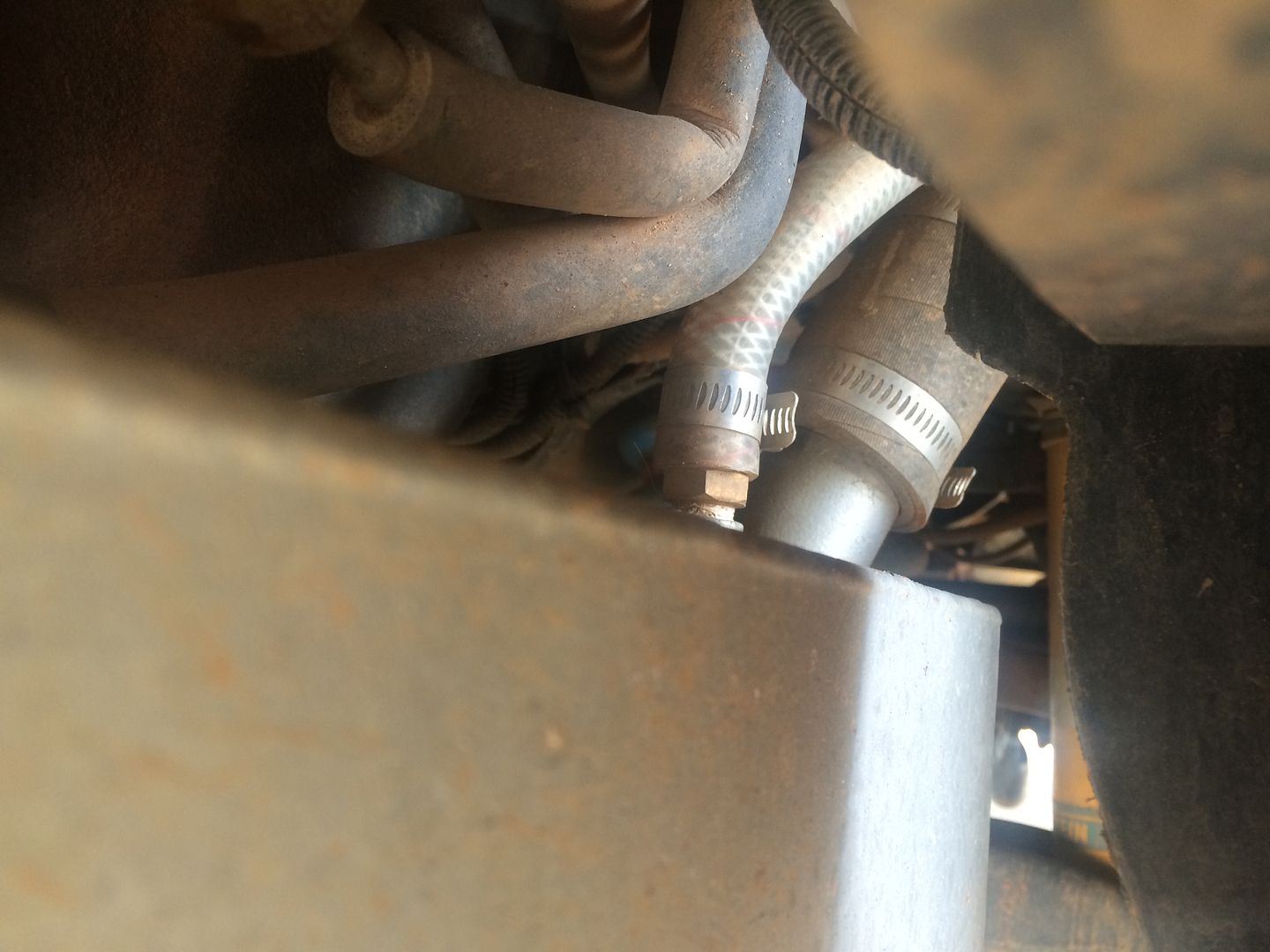

Would you post some pics of the side of the tank where the fuel filler connects to the tank? Maybe also take some measurements to see how much higher the tank could be mounted. I'm working on importing that tank but want more ground clearance so looking at cutting down / reducing the height of the factory storage and mounting the tank up higher.

I'll get a couple of pics up of the Aux tank filler pipes etc, although if you are going to the trouble of cutting down the rear storage area, it may be easier to just mount a tank in the rear storage well and cover it with a bolt down cover?
I am not sure you'll be able to tell much from my pics as it's a bit hard to get the camera in there. There looks to be a bit of room for movement on the filler pipe side of things though. In one of the pics below you can see the tank is basically flat up against the bottom of the rear seat well. I think if you alter the well, there should be clearance to get the pipes up another 30 or 40mm. Not really sure though, but looks possible?
Not sure if the above pics will help, I can take some more next time I have the wheels off and maybe get a better view of it.
