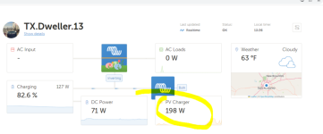

On my 22 D13, looking at the incoming wattage on my Victron VRM portal, I can tell you I either have:
"about average performing 90w panels"
or I have
"very under performing 100w panels."
I don’t understand how they say
I was also under the impression they were 100w Renogy. A fellow on the Facebook group pulled his up, and they turned out to have 90w labels.
or I have
