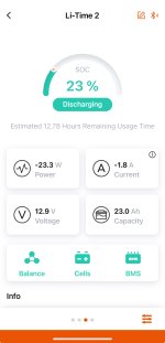

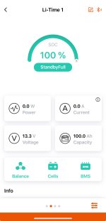

The original wiring has all 3 batteries wired separately all joining at the inverter ... I assume this is called a "Series" set up ?
I have turned everything on that could be turned on and only 1 battery ( batt no 2 ) is showing as being used... the other two batteries ( no 1 & no 3 ) are not showing any drain...
Is this because it's in Series so Batt no 2 will drain then batt 1 or 3 will kick in next ?
I've attached images of the Li Time app showing the 3 batteries , I numbered them 1 , 2, 3... bat no two is the first one on the set up to show drain...
Is my thinking correct ? If the system has charged all 3 batteries and only 1 is showing drain on the app then its a Series setup and the others kick in once the first battery ( no.2 ) is drained ?
Update on this, I've had everything turned on for 24 hours, battery number 2 ( the first to show a draw ) drained to 25% then battery no 3 kicked in, battery 2 & 3 are now showing a draw... battery no 1 still hasnt kicked in and still showing no draw... maybe it will start drawing when battery no 3 gets to 25% also...
All 3 batteries where 99% charged and awake when I installed them... everything I can turn on including a starlink has been running since 3pm PT yesterday as you can see by the li time BMS screen shots battery 1 still on standby..

Is there any chance your batteries are getting down to about 35* F and shutting down?
No - the batteries are not 'shut down' so to speak .. (and it's not that cold where I am currently) ... as the bluetooth/bms is active on all three and I can switch the app to see what's going on in each one ... also I have victron smart shunts on each battery and can see that only one out of the three is under load.... and when that one depletes .. load moves to the next one ... and so on... it's either fancy BMS stuff or.. more likely the way the three batteries are wired up ... pulling + and - from the battery nearest the inverter... as opposed to spanning the entire bank (as you mentioned above) ....
same same here Andy.. I've did a 24 hour test, turned everything on, only one battery ( of 3 ) is showing a draw, when it discharges to 25% it moves to the next battery I've emailed Litime will let you know what their reply is.

Team, I contacted Li-Time support to get answers on why the batteries ( all four of them ) were not drawing power equally.
Copy and pasted their answers below FYI.
Jan 19th reply from Li-Time…
Thanks for reaching out LiTime. If you connect the batteries in parallel, it is possible that the APP shows one battery discharged and the other 100% standby. This is a parallel bias current phenomenon, which is normal. Did you create a 4P1S system in the APP?
Jan 20th reply.
Thanks for your reply. When designing the LiTime Bluetooth battery, we focused on enhancing its ability to handle system surges by improving and balancing the BMS current collection accuracy and sampling range.
And finally, this allows our battery to accurately collect high currents of 500A or more, as well as currents as low as 1A.
When multiple batteries are connected to one battery system, the discharge current for each battery will be distributed according to the internal resistance of each battery. If the system is discharged at a lower current, it may affect the accuracy of the State of Charge (SOC) display for batteries discharged below 1A. And this does not impact the actual capacity or functioning of the system.
Two tips for improving the accuracy:
① Add loads to the system to increase the system discharge current;
Or ② Fully charge and discharge the battery system for one cycle to refresh and recalculate the State of Charge (SOC).
Thanks for your understanding and support. Have a nice day.
