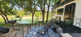

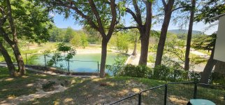

Here was our Labor Day trip to Concan, TX at Riverview Campsite by the Frio River.

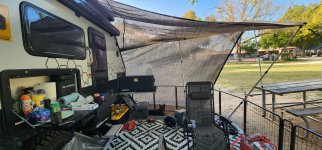

We have a "yard" now I am going to call the dog mod. Previously we had all three leashed up, getting tangled and stuck under chairs constantly. I also had a fear of them wrapping around the support for the awning and tearing that thing down.
What we did was put a large tarp on the ground and then used bungee cords to secure it under the trailer so the dogs couldnt go underneath the camper to escape. Then these fence pieces have a stake that goes through and you can tamp it into the ground. Link below
