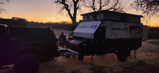

2022 Dweller 13
New enough that the control panel is to the left when you enter the door on the side of the settee. The batteries are under that same seat.
The dealership bought a few at auction, not sure how many but they did say they had a 15 that was sold recently as well but the 13 I bought was the last of it kind on the lot. It had been stripped of the feezer and outside shower curtain setup, but the dealership had replaced the cooler with a ICECO model. They weren't moving well and it was likely heading back to the auction block again had I not purchased it. Everything else looks to be pretty standard to what I have read.
How it Towed.
The first stretch of road leaving Fallon is a max speed of 65. The road is well maintained and 65 was what I towed it at. For a "Mid Size" truck, this trailer is the perfect size. I had plenty of power pulling power and on this section it track well without any sway or wheel feedback. The mirrors on the truck are adequate, though I'm interested in a camera setup for the back of the trailer.(I had a semi pulling a corner at an intersection that needed more room and I had to have the Mrs jump out and have the car behind me back up and then signal me how much room I had to reverse..) I dont need it, but man it would it be nice! The new full size Silverados have ghost trailer camera setup but I dont think its doable on the Colorado...
The squat on the truck is more than I like(see picture below) and the truck canopy, tools and amout of gear I had in the back of the truck didnt help. I have a set of RAS(road active suspension) helper springs on the way that get here Tuesday that should address that issue, however in truth, I was 80lbs over the GAWR for my rear axel and within 170lbs of GVWR. I found a set of scales along the way that I could peek in the scale house and see my weights. Front Axel 2400, Rear Axel 3680, Trailer Axel 4800.
I did not disconnect to see trailer stand alone weight. Could I have lightened the tongue weight or repositioned the load in the bed and been within, probably. Two 30lb bottles full, generator, bottle jack and Jack stands in the front box, only the front water tank full. In my opinion theres room to adjust. Moral of the story is, if you're running a mid size truck just know you cant load er' down like the Clampetts!
After a long drive from Washington and getting the trailer loaded we didnt make it much further then the far side of Reno, and ended up staying in the Cabelas parking lot for the first night. Early the following morning, after a short run on I-80 we headed off onto 89 north through Sierraville, the back side of Lassen, Hat Creek and made the turn west at hwy 299. That stretch of road was perfect for this setup. Most is 55 mph, windy roads with little traffic. We setup the trailer for lunch and a nap on a dirt trail somewhere around Hat Creek. The trailer is great for that. Simple, fast setup. Easy to whip into a side trail, without worrying if you'll be able to turn around and easy enough to bounce over a rock or two to get it into position. The bed is super comfortable in my opinion, and a bathroom that is always available (my popup had the same cassette toilet setup but was inaccessible without setting the whole thing up) is amazing! The room inside the trailer is adequate. It's just my wife and I and we're used to dancing around each other in our little c-dory boat for days on end.
We stopped at Wisky Town Lake, specifically Brandy Creek Campground for the next night. Weather was rainy the whole day and only got worse as we passed through Redding. The campground spots are a bit wierd, think wide parking lot spots.. It was only us and the camp host in the place so I parked how I pleased across 2 spots and left the truck attached which in hind sight was helpful. We had a nice quiet dinner and were really hopeful for just a relaxing night to finally unwind..Then the wind started... 50 MPH winds slamming the side of the trailer. Lightning, lighting up the sky and trees over the top of the trailer swaying like crazy..We lowered the top but left the bed extended, I put on some rain gear, jumped in the truck and repositioned the trailer into the wind, and as clear from the trees as possible. Disconnected the truck and parked it sideways to help block the wind and called it a night with the top lowered down just incase. Three trees were down in the park the next morning, but luckily none near us.. Looking back, we could have left the top up, it handled the worst of it, but the unknown was enough to error on the safe side..
The next morning we pushed up the coast to the 101. Got a photo with Paul and Babe, hiked a spot along 199 in a redwood grove and decided since we were running low on time we would continue out 199 to Grant's Pass then north on I5 home.
It was getting late and with nothing but a couple of DNR road possibilities for the nights stay, we swung into a gas station for fuel around Obrian Oregon and noticed a restaurant across the street that was still open on a Sunday night. My wife hurried across the road to get us a table incase they were closing early while I finished fueling. As luck would have it, the glass of wine I ordered happen to be the brand owned buy a couple that walked in the door minutes after. The owner Reggie, asked what I was drinking, then clued me in that it was his wine, a local vineyard two minutes down the road. They were great folks to talk with, asked where we were staying for the night, and when we replied we hadn't quite figured that out yet they suggested their winery, complete with RV hookups on a beautiful ranch. Sold! It was dark when we rolled in but an amazing place to wake up to in the morning and I'd highly recommend them if you're in the area. https://augustinoestate.com/
Towing continued to be good the next day through hwy 199. Once back in Washington on I-5 is where it took a little more concentration. Nothing I would concider "white knuckle", but the ruts from the heavy trucks that run the interstate + traffic + higher speeds of other vehicles required more attention and speed control then before. Sometimes I'm doing 65, sometimes less. Nothing that made me feel unsafe, but I could see how some folks that dont tow alot could worry. We got home late that night after a ferry ride (total vehicle length barely less than 40' for those of us that use the ferry system).
