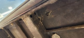

We didn't expect it to get as cold as it did last night.. all our water jugs outside froze and with everything defrosting we noticed water dripping by the right hand corner of the door and from where the door meets the trailer at that 90degree angle above the mudflap, and from a part under the trailer... not sure if this is just condensation dripping down or if we busted a water line or if this is normal.
I would guess it is condensation. If you look under the trailer you will see a majority of the water lines are exposed. The only interior water lines I believe are on the drivers side of trailer under the bench seating that feed the shower, sink and water heater. At least in our 15 anyways. That being said, water travels in weird ways though. If it where me I would check under the bench seating, bathroom sink etc... If any of the interior water fittings are leaking, I would expect to see a water streak running along floor.
Good luck !
Good luck !
We figured it out.. our inside sink was leaking. Didn't notice it until we got home. The seals along the front cabinets were really good but the whole front of the camper got soaked. Its been a hassle dealing with all of this with the rv place and all the water damage especially since we just got our camper on Friday.
I believe the only wood in the trailer are the cabinets, if that helps. According to obi their floor is some sort of composite honeycomb.
Who installed sink for you ? When I installed sink in my 15, drilling through the floor for drain line, the flooring was this honeycomb thinga ma jigger material. Hopefully water damage to cabinets would be a minimum. The cabinets are plywood and much more solid then particle board etc....
