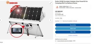

Do you go solar panel to battery? Or do you have a solar controller somewhere in the mix?
