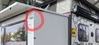

Has anyone experienced bending and cracking of the latch plate for the pop out bed platform? Specifically, the thin metal plate that holds the rear bed platform up when stowed? Yesterday I reinforced both sides with powder coated steel L brackets and 1/4" bolts from HD. Took some cutting and drilling.
Do you mean there? where the side pieces hold up the top piece? The L part of the side pieces for us have bent after only 2 months. Do you have pictures of what you did?

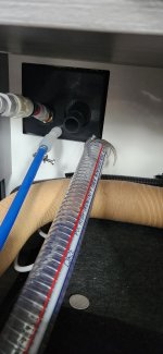

Anyone experience their water (inlet maybe?) hose constantly popping off? This is located on the 13 under the smaller cabinet over the wheel base.
Yep, happened to us. They used a section of tubing JUST a tad too short and with the smallest amount of water pressure filling it, it let loose. We just upgraded the clamp to a better one and jammed it back together and tightened it up REALLY tight. Hasn't come off since.
And while you're in there make sure those city water plastic connections are good and tight also. Ask me how I know this.
Which ones are the city water connections?
I'm assuming you had a flood in your camper? Don't worry, you're not alone!
The city water internal lines are in the left of your picture. They have the grey plastic Hex connections you can put a wrench on.
No flood, I saw water dripping out of the front left of the camper on a dry day immediately after hooking up the hose to the city water connection. No damage.
