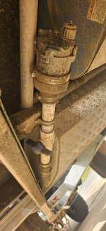

I was wondering what people typically use to empty their grey tanks on the Dweller. There are two valves, one of which fits a generic garden hose, but I'm unsure of what fits the larger valve.
If you have the grey colored pipe running along the driver side, use this to adapt to standard RV sewer hose. Or water hose. Which ever you desire. It'll do both. You can also add an elbow for easier access, but I preferred the ground clearance.
A- Original grey colored metric pipe
B - 1.25 x 1.5" flexible coupling
C - 1.5" PVC pipe
D - 1.5" PVC valve
E - 1.5" x 3" flexible coupling
F - Pipe to Bayonet adapter
G - Gray water drain cap
You can probably find most of this stuff at Home Depot, if you so desire. I think I put it all together in about 15 minutes. You can use a regular RV sewer hose, or a standard garden hose. Let me know if ya'll have any questions or want the links to any of this stuff.
