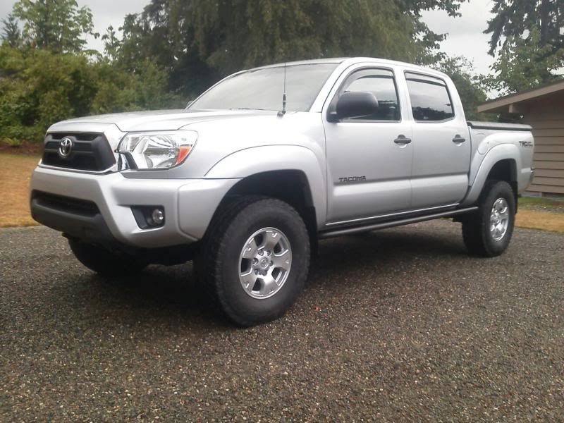

Well here is what I have been up to the last two weeks. Installed ICON stage 1 Coilovers and shocks, Dakar rear springs, 1.25" Spidertrax wheel spacers, 265/75/16 Falken Rocky Mountain ATs, Co2 bottle, and a Cobra 75 CB in the console, and also Stubbs HD-SKO sliders with the legs shortened 3/4" and gussets added. Just got it back tonight and hopefully the squeak in the body is over, they said they found the source and welded so we will see.

Wondering how much lift your coilovers are giving you/set at? and what your CV axle angle is like?...
After wearing through my inner CV boots in 25K miles after the OME/886 combo I am thinking about switching to the icons and leaving them at 2" of lift to bring down my front end...

Actually the ICON's are set at 2" right out of the box and that is what I left them at for now. The Dakars are a little high in the back but they should still settle down after awhile from what I'm told so I will wait to doing anything up front until that point. The CV's fins are not touching and when I got the alignment with the stock UCA's they were right in spec.
So far all of the mods are working out except for the rear ICON shocks. They are sending me a new set here in a week or so whenever they get more built. These have a squeaking noise at real low speeds, I talked with ICON and tried spray silicone grease on the shafts, checked the upper bushings but in the end it sounds like the seals aren't right. They work and perform great but that noise is just enough to drive you nuts and a higher price shock like that should be quiet like the front ones.
