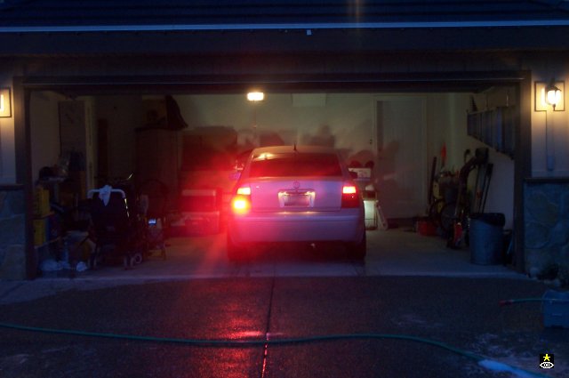

I tinted a set of HID lights to selective yellow and ran them for years. Worked great in the foulest of foul weather. Now I just use JW Speaker LED foglights which work just as well in plain old white.
I bought these a couple years ago on Amazon, very old school and cheap.
I was surprised that the white side does throw out a round, spot type beam. Nothing like the fancy ones with ballast,LED etc, but do help a lot.`
The yellow side throws a wide, flat flood beam.
They each run off their own relay using a tap in the headlight wires: high beams the white "spots" go on, low beams the yellow floods.
I used PennDot site as guide to keep as legal as possible. Never had an issue with police,inspection or other drivers.
There is also one mounted on my spare tire rack on the back. I used "ricer red" lens spray to change the white side red.
The yellow is tied to the reverse light and red to brakes.
