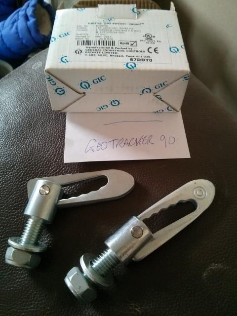

This little parcel left for the USofA on monday...
:smiley_drive:
