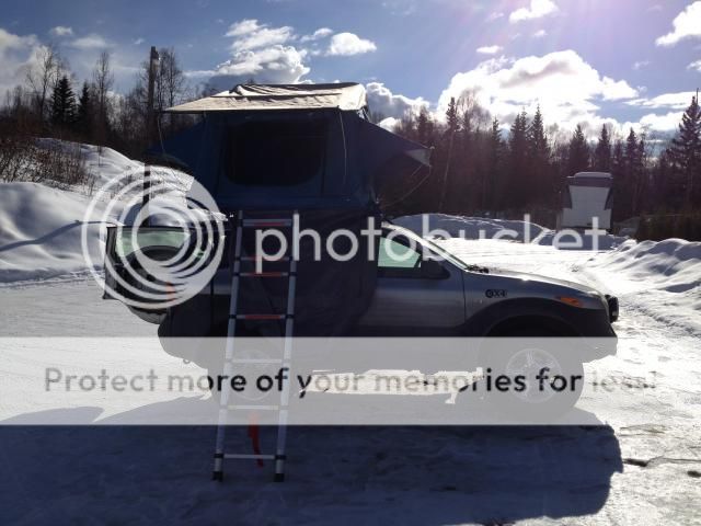

Here's some Roof Top Tent, LED lights, and the cooler :)
What do you guys think?

Other than that all I need is to finish the wrap, awning, OME springs, and a water tank. Looking forward to my first camping trip/hike this spring!
your tranny will not like those lights there (unless you swapped in a 5spd)
spare parts?
Have you already modded the TOD for selective lockup and use in LOW?
maybe a spare lockup solenoid for the TOD (they do burn up and a spare will not be fun to find)
stock tierods(or upgrade to hvy duty ones)
a couple c/v boots
not much more than normal for maintenance
and unless you add alot more places to use as jack points, just leave the heavy thing at home
So far (alaskan winter) no heat problems. I don't know how to do a true TOD off, I heard it was a myth more or less. Getting some OME 919 springs (heavy load Trooper springs) and some manual hubs.

which model of tepui tent is that? i was thinking of picking one up for a trip to alaska/yukon next year.
I had one for some time and a good friend had one. We both got rid of them because of the high oil consumption and frequent transmission problems. Isuzu used a POS Chevy transmission. Be sure to keep a radio or phone with you.
Thankfully I don;t have oil burning issues yet and the tranny is solid on the road so far. The lift is going in next Monday, pics to follow. Threw the bike on it this week to begin the Alaskan cycling season (it's a fixie...gasp!) Planning an overnight to Portage this weekend and a prototype awning that will hopefully be made by Alaska Tent and Tarp.
