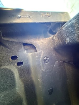

Finishing up my build on our “Bread and Butter” OVRLND camper. It’s sits on a 2001 F350. The framing for the build out is welded steel tubing paneled in HDPE. Walls are insulated with an 3m product and paneled in “bubble X.” 400w of solar and a lithium batt to power a water pump, 12v fridge, vent fan, diesel heater, and some 12v and USB outlets.
