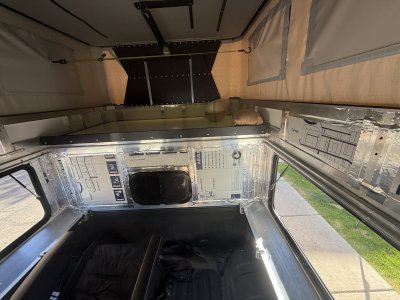

Interior progress. Insulated with R6 foam board, added a bed rug, and hid some wires. Really liking how it’s coming together
It’s looking good!
Re: the Bedrug. Love mine, but I found that with use going in an out and lounging on the TG at camp the thinner foam under the TG compressed into the corrugations on my TG in a way that the interior bed did not as its thicker. Maybe the Ranger’s will be better, but I ended up going back an filling in the valleys in TG. It helped, but I still have ripples in the TG part of the Bedrug I wish I didn’t have.
Might be worth to pull up the TG Bedrug and put something under there to help keep it flat and nice, unless you have a flat TG to start with.
It’s looking good!
The corrugations on the tailgate are deep and many, so I'll have to get them filled in sooner than later!

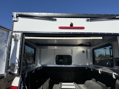

Nice work adding the cameras F/R, that helps a ton. I did something similar to my truck.
Any reason you mounted the rear camera above the brake light?
From my experience, mounted that way at night, all you will see is the red LEDs.
I mounted my rear camera up high as well. Down low I had more water spray in rain and snow covered roads. I still get a little, but much better now.
