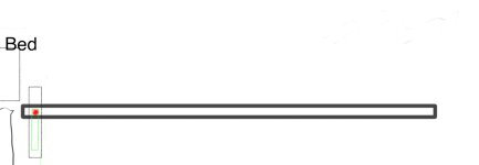

I initially had some trouble on hard acceleration but my thicker mattress locks it in pretty good now. But I was going to make a simple latch to bolt to the unistrut (or 8020) bed slider.
Basically take a piece of bar with a slot and have it on a bolt at the channel. Have the slot off set so that it sticks up blocking the bed. Then you can just pick it up and flip it around.
Hard to describe so maybe I’ll draw a pic

Bad drawing. But the long horizontal box is the bed rail. Short vertical block is the bar in both open and closed position. Green is the slot and red is the cut out bolt. Pretty low tech and could be made with scrap.

Thanks for the reply.
I was thinking about something that was similar...
Perhaps a peg or bolt that drops into place to keep the bed from sliding out, but can be easily removed to pull the bed out.
I'll keep playing with some designs...
