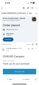

Signed my contract and have a rough completion date of mid- December! Now it's planning time.
Order of operation is sell the RTT, rack, and tonneau cover (if you know anyone with a 19-23 Ranger I'll sell it as a package deal). Seal the bed and hopefully install a bedrug before install.
Electrical seems like it should be the first thing to go into the camper itself, then insulation and wall coverings. Going to try and keep things light but feature packed.
May try my hand at building a bench that houses a slide out kitchen. If anyone has any good 8020 design resources it would be greatly appreciated!
