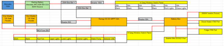

Still have a ton of planning to do, but pretty happy with where I have my wiring diagram so far. Any input would be appreciated!
Going to build my own battery box out of a tool box since I am just not happy with any of the traditional commercially available power stations. Was using a Ecoflow for the 6 month but luckily I bought it from Costco, so it's going back to fund my build lol.
Nice work on the schematic.
I had planned on building my own battery box as well, in the beginning.
However after deciding I wanted a portable unit to move between rigs or home use (when power is out), I settled on a National Luna product.
Extremely satisfied with the product!
Have fun with the build!
Cheers
Cheers
That National Luna is definitely a bomber setup, but the price tag kills it for me.
This Renogy charger and this 200ah LIFEPO4 are my main price investment in the system I'm looking to build and I should be able to snag them for under $500 combined.
