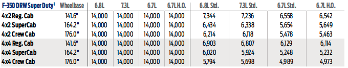

As you found out in the other thread discussing ventilation, an important point is to be aware that the brochure/website payload can differ substantially when you're on the scales.

The DRW F350's have a decent bump in payload but you'll still be carrying some limitations from the smaller trucks (specifically, turning circle). The F550 will take up the same amount of pavement/parking space as a DRW F350 and be able to carry more stuff, which is exactly why you've started this thread to begin with.
To your point about trucks being hard to find, the pool of DRW F350s is going to be smaller than SRW F350s. I think since you don't have a truck, you might as start where you want to end up...
To answer the original question, 75-80% seems like a good number.
