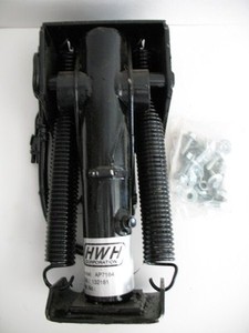

Didn't get much done today, but I spent all morning searching the internet for stabilizer jacks. I figured since I'm getting older and more lazy, I should get the good stuff, right? You know...flip one switch and the jacks come down and level the camper automatically. I found this used set, but I would still have to mortgage my house to afford them. They will lift 9,000 lbs. each, so changing a tire would be no problem.
Seriously though, finding stabilizer jacks that will mount under an ambulance body is not as simple as it sounds. The body hangs down (the compartments) on three sides, making the frame inaccessible from the sides or back. Light weight jacks used for stabilizing only, could be mounted to the underside of the body itself, but then I would lose valuable ground clearance and probably knock them off.
And to make things worse, the more I look at that picture of those power jacks, the more I want them.

These will be mounted in the OEM battery box located in the right front corner. I'll start with this arraignment, but if it's not enough I'll add two more to a compartment on the driver's side. I'll be going to pick up two of these bad boys Wednesday.
You will love power jacks. Can you use ones that mount to the bottom of the frame? You lose a little clearance but not a ton. My HWH hydraulic ones swing down from the bottom of the frame rails. The tire guys did think it was nuts when I just picked the front end up :D
I'm sure there is a way to make them work, but that set there is $3,200.00 and came off of a Fleetwood RV. I've got a lot to do yet before I consider something like that. I'll probably be using my old 6 ton Goodyear jack stands for a while yet. :)
Fair enough. They are nice though, the kick down ones you don't need to find all the vertical space for them, onmly 4-5" deep when closed up, do need to find a spot for the hydraulic pump though.
