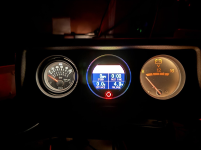

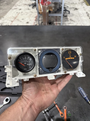

Yet another long time with no posts. But got the brento-box back up and driving under it's own power. Clutch install went well and we're back on the road. I did install a new VDO oil pressure gauge with VDO sending unit which give me a bit of peace of mind. It fit into the stock location with just a bit of modifications.
Debating on taking the voltage gauge out and making it into a VDO boost gauge there. Would be good to see what exactly we're sitting at on the turbo waste-gate. The next big thing I think I need to take on is getting this wheel alignment figured out. After installing the OME torsion bars and cranking them up a bit I'm definitely wearing those tires on the outsides. Lots of positive camber. Reading some old posts it looks like this is done by shimming those UCAs.
