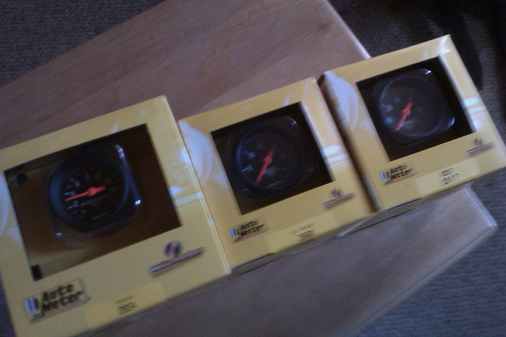

I got some new accessories in the mail today.....
EGT, fuel pressure, and boost...
Now....where to mount these dang things?
Metcalf
The pillar is an option for sure. I am hesitant to mount them there because of the 'wanna race' diesel truck scene in the southwest. Pillar gauges generally attract a lot of attention.
My most recent thought was to replace the 'information' cluster above the climate controls with a 3 gauge mount. I think I could french in some modeling plastic sheet pretty easy and paint everything so it looked pretty factory. I would lose the indicator lights for ABS, wait to start, and water in fuel unless I spliced in some new bulb holders and moved them somewhere.
Does anyone know if a small indicator light ( regular bulb style ) that is panel mount and you can add a lighted label of some kind to?
Bogie
I'm a fan of under dash mounting bu I use the larger 2-5/8" gauges. check out K-4 Electrics for indicator lamps
huntsonora
I love your truck but the last thing it reminds me of is a race truck:sombrero:

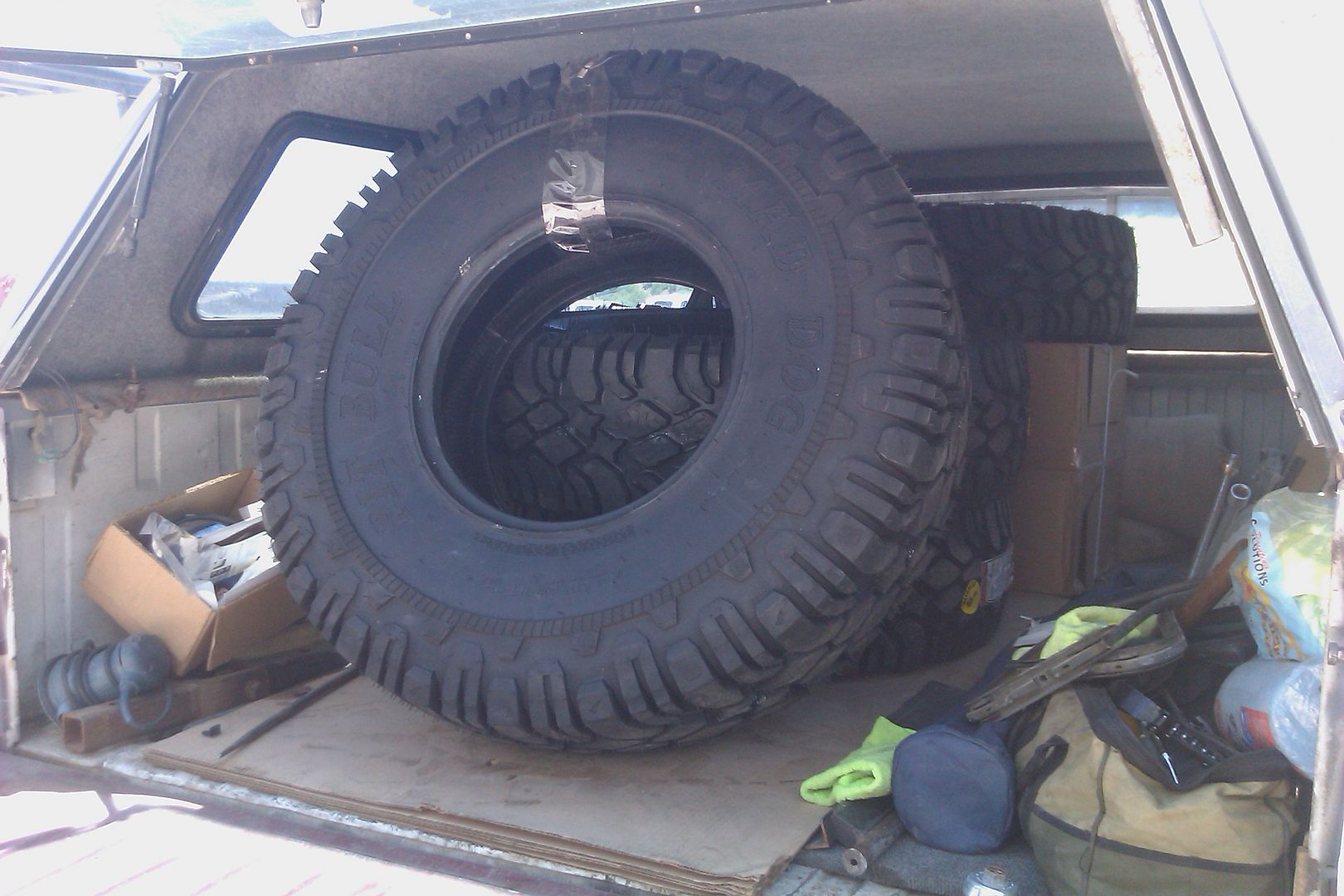

I love the smell of new tires in the morning....
Excuse the mess....

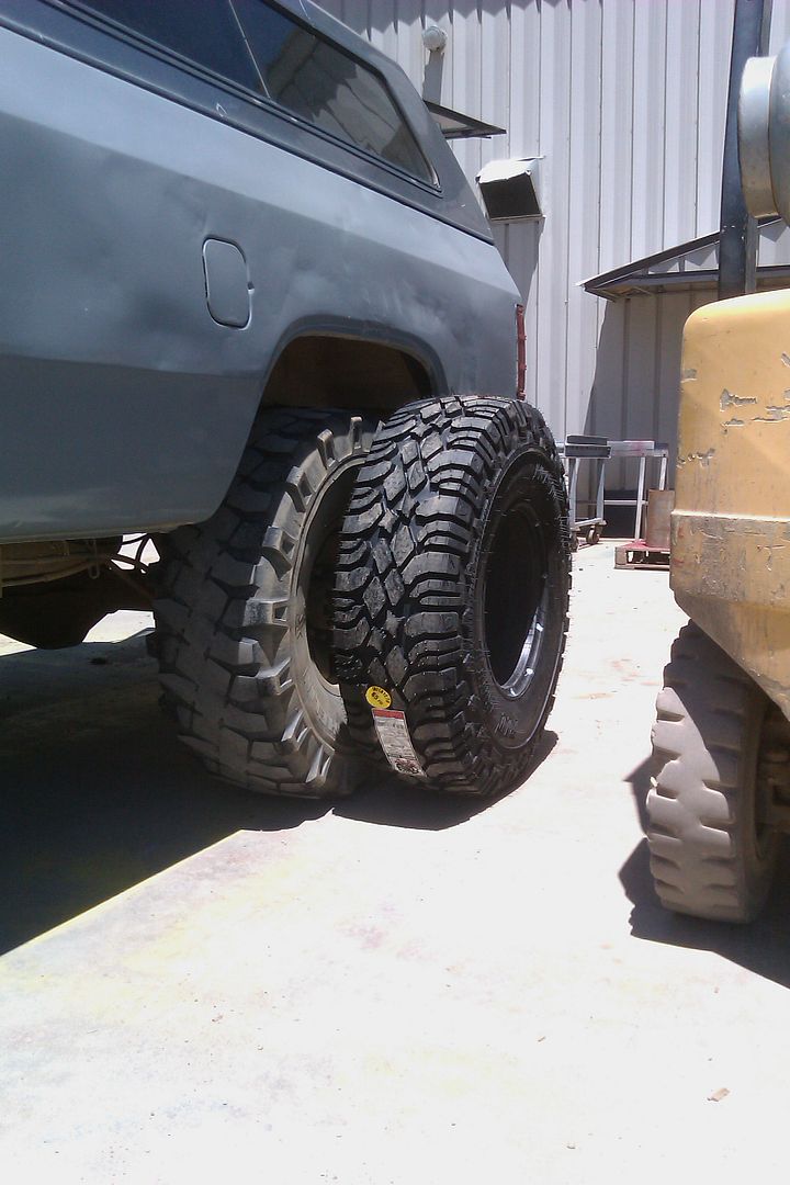

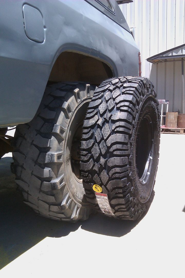

At least 1-2" taller than the old 325s unmounted. I would suspect with air on a rim they will be just about perfect....
The tire and the tread are MUCH more beefy in person! The tread is also nice and deep at 21/32nds.
Me like.....
