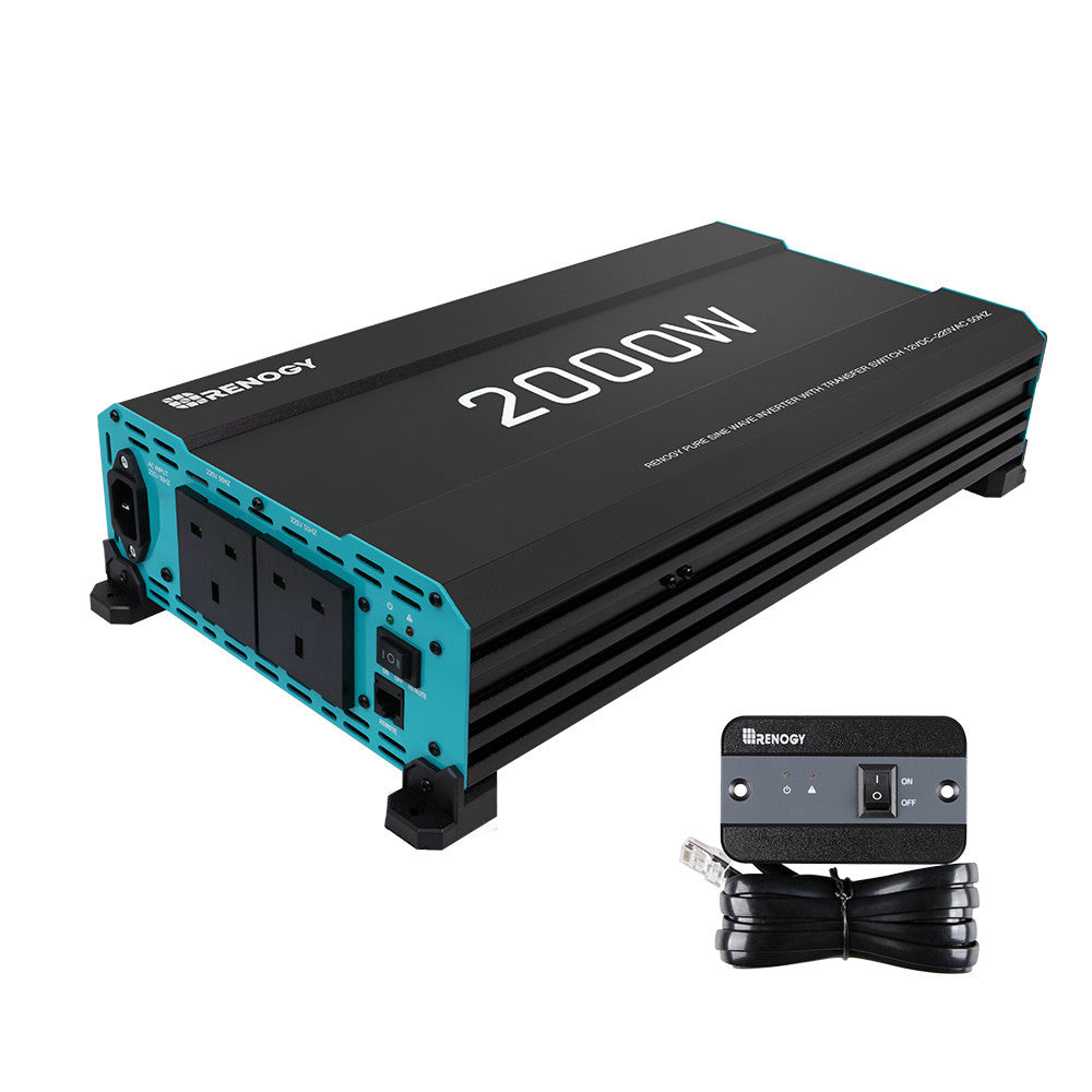

The truck has a factory inverter but it's really weak(400w) and it won't push it.
I'm thinking a better inverter like the one in the link below but I'm just curious what other people are doing to re-charge these large portable power stations these days.....
Or would i be better off going DC to DC?

1. Dc to dc, get a CONVERTER, run it off alternator, go to 70V, run 2x 8AWG wires back to the power station solar input. 11A about.Place converter near alternator to minimize large cables.
2. Or, inverter. Place inverter near alternator to minimize large cables. Run same 8awg wires for 120v 12.5A 1500W supply to power station. However... 12v at 1500W is 125A, your alternator can't do that without burning up.
You need to assess what your alternator can supply, the 400W existing inverter may be it.
Read my threads on this. Here is a summary one with vids
starter battery -> inverter -> wall adapter -> power station like you describe is a fairly common workaround for the issue.
As Dave points out having a 1500w wall charger does not guarantee your alternator will be happy to provide another 1500w (plus inverter losses).
