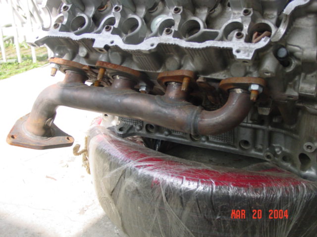

Here's a pic of how the headers MUST look like with the VK56 engine from an Australian guy who made the swap too:
Mine looks somehow similar but bigger and thicker, and of course it's custom made. They look like this one but 2-2.5" for each port, though the port itself is 1.5" but for better breathing, and the rest of the exhaust is 3": OEM headers for Toyota's 1UZFE

As told you before, we're FORCED to make it like that one. I should make a picture as soon as I get to the garage. Thanks a lot for all the details!
