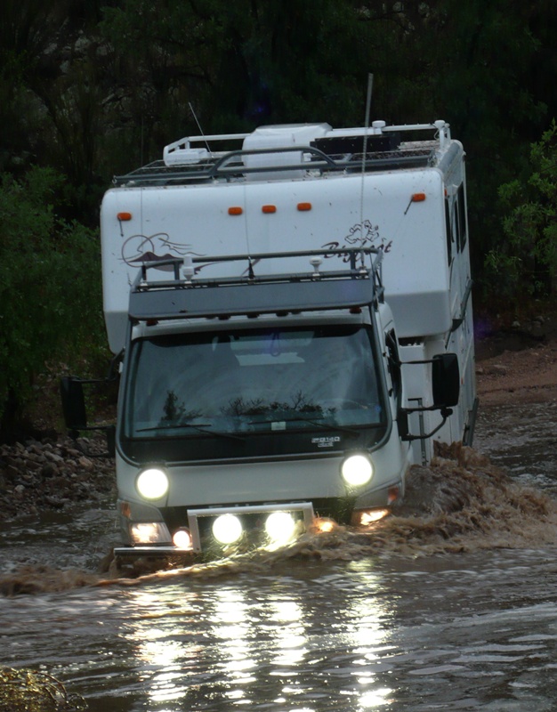

Our fabricator, Mark Johnson, built a rack for our cab. It's made of high strength aluminum and the rack itself can be easily lifted by one person.

The integrated brush guard around the windshield proved to be a Very Good Idea in the field.

Here's what the rack looks like on the truck:

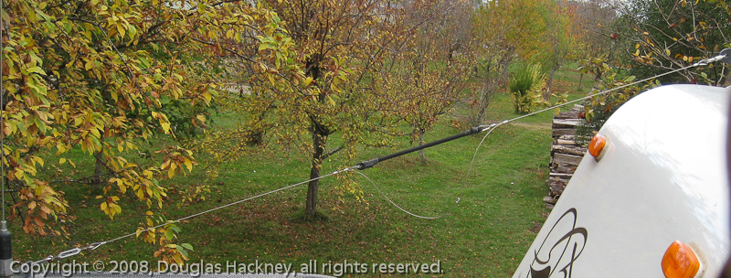

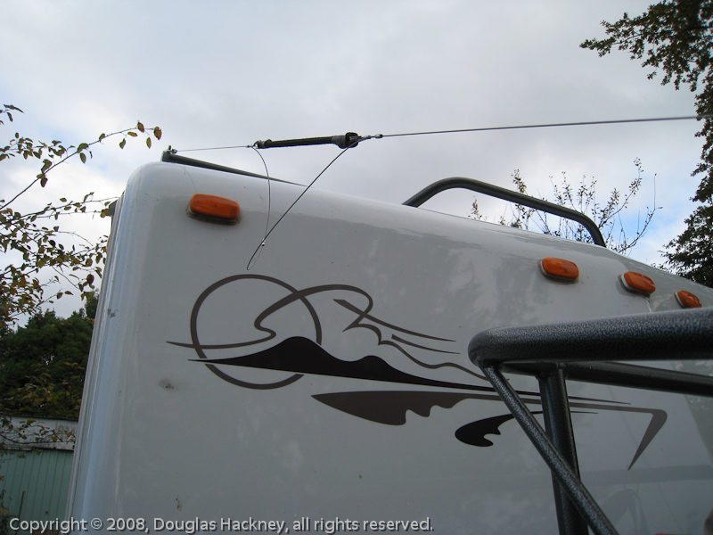

If you don't have a lift-top/vertically expanding camper, it's a good idea to install lanyards from your cab rack to the front corners of the camper.
Scott Brady suggested this when we tested with him and I built and installed some while we were exploring the U.S. Rockies & Pac NW prior to leaving for South America.

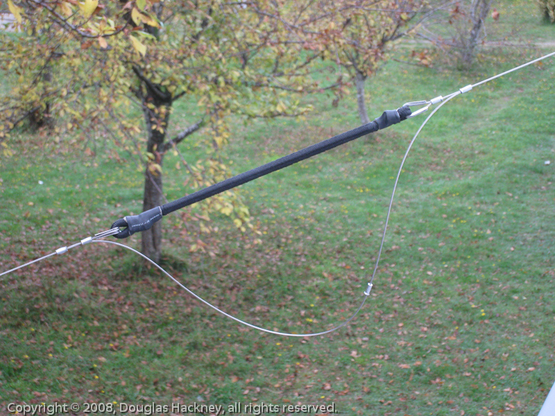

I have no idea how many times I rebuilt them before I finally got the right proportion of shock cord to stainless steel wire. I quit counting at five. If nothing else, it gave me something to do for the two years we were out.

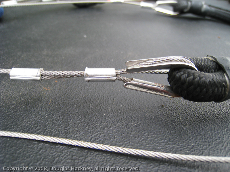

It helps to have a vise, swage tool and a bunch of parts, shock cord and cable. (We needed the shock cord because we had a lot of movement between the cab and the payload, so the lanyards could not be taught.)

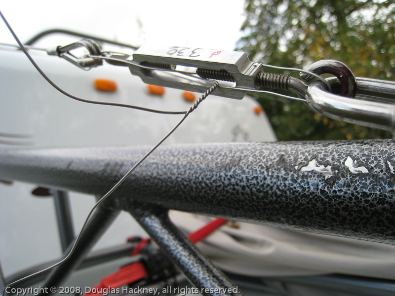

Make sure to use all stainless steel hardware for this project.

The shock cord is tied off / wrapped with safety wire and then covered with glued heat shrink.
Stainless steel safety wire (used in motorcycle racing, available at any good motorcycle shop). This was shot before I clipped the twist and tucked it into the turnbuckle.
The shock cord held up very well to the elements. It's from an inexpensive bungee cord.
The lanyards were a Very Good Idea out in the bush. They kept innumerable trees off of the front of the camper and provided a smooth glide path to guide anything bendable up, over and down the sides. Thanks again, Scott.
