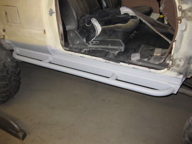

Rocker rebuilt with slider - very cool!!! and by far the best way. eliminates snag points under the truck. solid weld over entire length distributes weight evenly
http://i291.photobucket.com/albums/ll293/lgraham09/85 4Runner build/IMG_0189-1.jpg
