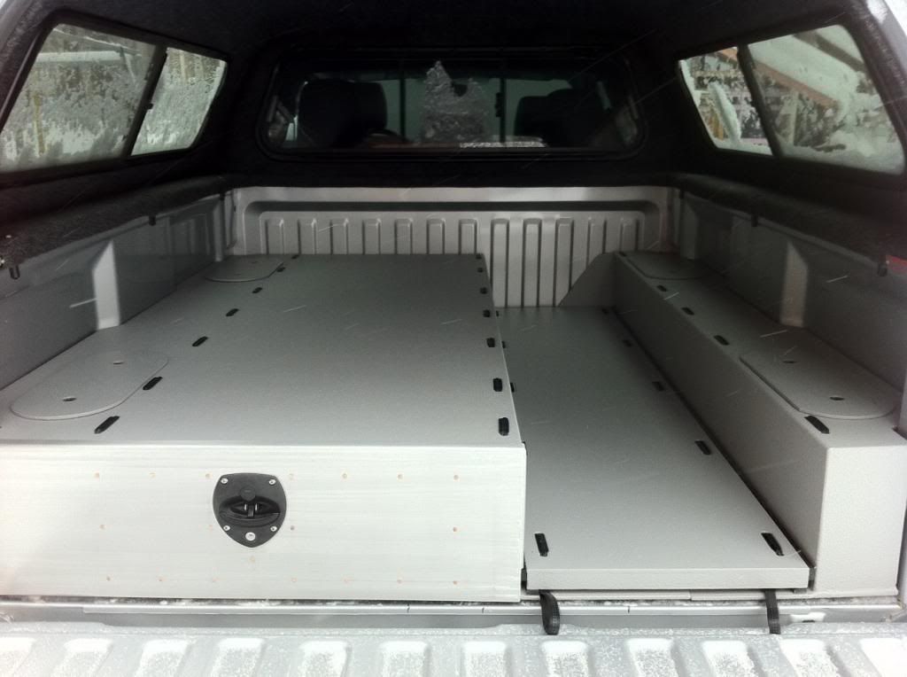

Really intrigued with your alu drawer face...I love the mix of materials.
This sort of detail shows real thinking...very cool. Moe

I too like the look of the drawer front especially with the copper rivets that really can't be seen in the pic.

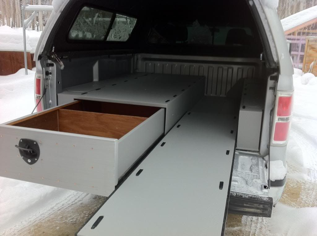

Just as a public service announcement...Correct me if I'm wrong...the UHMW slides you are using are not the King Starboard material commonly available - that's good stuff but for slides & ultimate durability you want ----
Ultra-high-molecular-weight polyethylene UHMW-PE - This is the good stuff - more expensive of course.
Very-high-molecular-weight polyethylene VHMW-PE - This is an in-between grade King Starboard sells - I've never used it.
High-molecular-weight polyethylene HMW-PE or HDPE - This is the stuff called Starboard - very useful but not slippery enough for slides nor as tough.
I'm a bit confused about your alu drawer front - is that a solid thick piece or did you do something clever to get it to wrap around the wood drawer face? Love the copper rivets, great look.Moe

The drawer front is .125 aluminum bent on the top and right sides in a brake.

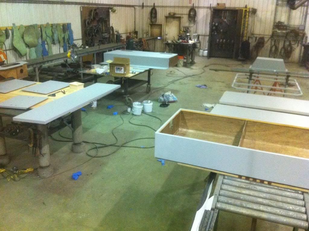

Here is a link to some boxes I built for a raft that may help with building a chuck box.
The shop belongs to a ex employer that is kind enough to let me use when needed.
99% of the time I build in the puny little garage in most of the pics.
