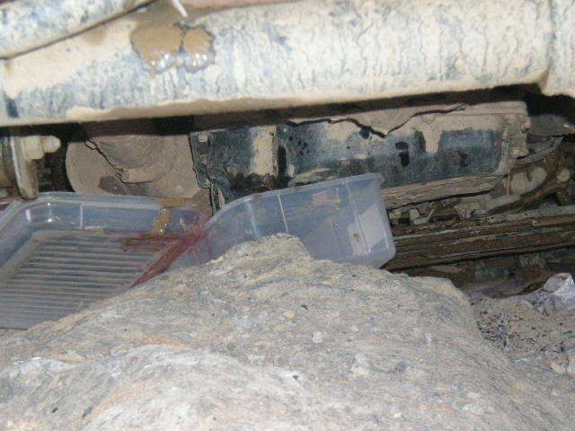

Well, 8 weeks after starting this frame rust stuff with Toyota, I finally got some info. Because I am over here in Germany with the military, it was not a typical case, for obvious reasons.
After this and that, my case manager today finally told me to put the truck up on the rack, take pictures of the damage, and send them to her in an email. She said it was the easiest way, instead of trying to tell the German Toyota dealerships (they dont have tacos over here)how to do the inspection, blah blah blah. She basically told me what I needed to find to have my truck bought back.
Holes.
No holes, no money.
It doesnt matter that I have 4inch chunks of rusted steel flaking off, apparently that is the same as "surface rust" (which of course is bull, and she knew it), but she was way cool about it, and basically told me to find a rusted hole in the frame and I would be set.
I checked the frame a couple weeks ago, and the metal dented very easily in front of the spring holders.
Today, I put the truck up on the rack, and hit the frame with a ballpean hammer like the Toyota PDF says to do, and the second hit it went through the frame. I was honestly surprised how easily it went through, as the frame does not look bad from the outside compared to other I have seen.
I sent my case manager all of the photos and info, just waiting to hear back from them now. I will REALLY hate losing my taco, but I dont want it if its going to be dangerous or fall apart (literally) in a years time. The money they are paying is too good to pass up.

Max, they had some issues with treating/sealing the frames from the factory on the 95.5 - 2000 tacos. I have heard of a few rust issues on newer 05 up trucks, but not to the point of holes yet. Just surface rust. The problem with the older gen tacos is they were rusting from the inside out. The outside of my frame looks good (other than slight surface rust, and obviously a lot of mud), but many of the trucks you can put your finger right through the frame rail even though it looks ok.
Taco Chaser (sorry, I dont think Ive ever seen your real name!), I assumed (wrongly) that everyone would know what I was talking about. Its not an official recall from toyota, but its "voluntary". They are saying its a 15 year "extended warranty". They have bought back TONS of tacos in the past two months, and now they are getting overloaded with the amount of trucks who have very bad issues with rust. Here is a link on TTORA discussing the issues.
http://www.ttora.com/forum/showthread.php?t=95993
The frame has been strengthened on the outside with the Demello frame plates, but this is obviously a little further towards the front of the truck. If Toyota buys the truck back (and they most likely will), I have probably had my last wheeling days with this taco. If for some reason they dont buy it back, I will rebuild the entire truck from the cab back. It will become a serious project. My frame is probably one of the best looking frames that actually has a hole, most of them are completely shot. And they tend to start where mine is rotting, and go from there. Here are a few shots of some seriously rotted frames.

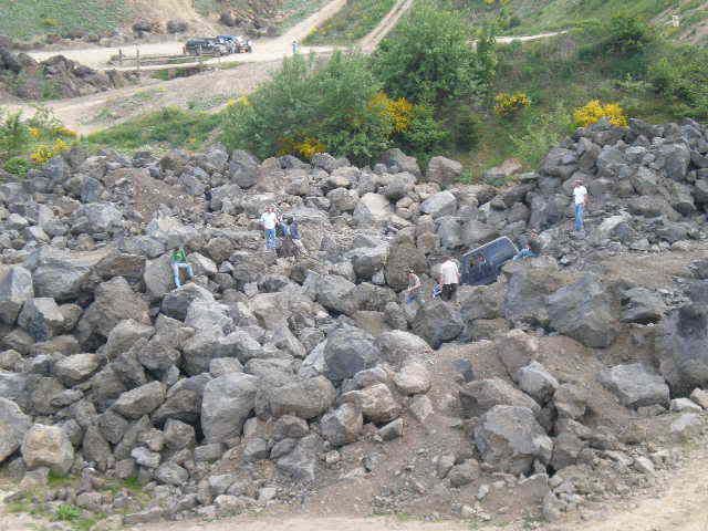

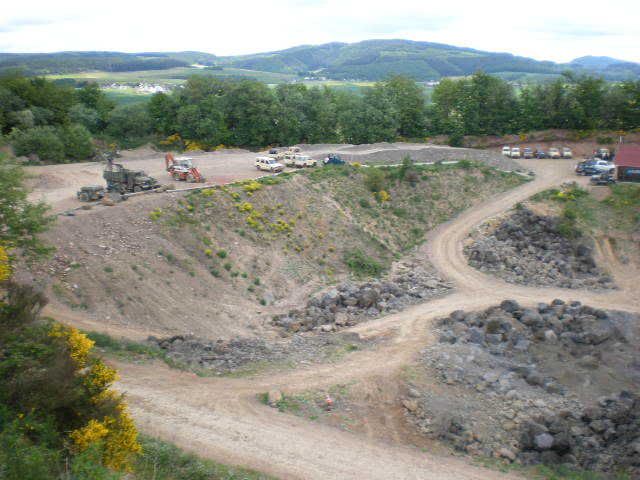

Well, this weekend was most likely the last wheeling tirp for my taco before Toyota comes and sends it to its early grave. It, as usual, performed flawlessly, unlike the Jeeps I was with. I decided that since I was going over to the Jeep side of the wheeling world, I should make friends with the local Jeep club and go with them. They were a really cool groups of folks, and we had a blast. They gained a new respect for Toyota's wheeling ability, and I think I will be right at home with this group once the XJ gets over here.
Here are a bunch-o-pics:

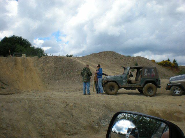

Jeep Carnage:
TJ #1, ripped open tranny oil pan after a pretty amazing rock run. Did great through a wicked line, then on the exit the tranny pan popped open.. Took it off, and mig welded it shut, drove it home.
TJ #2, broken U-joint, had a spare fixed it. Same TJ, broken brake line, had a spare, fixed it. Same TJ, shifter linkage fell off, fixed it.
TJ #3, broken front Diff, removed drive shaft and continued the day in 2WD.
Grand Cherokee Limited, completley destroyed passenger side sheet metal in the rocks, had no business being there without armor and completely stock. Same Cherokee, security system malfunctioned, and would not stay running. Had to call a tow truck to tow him all the way home.
