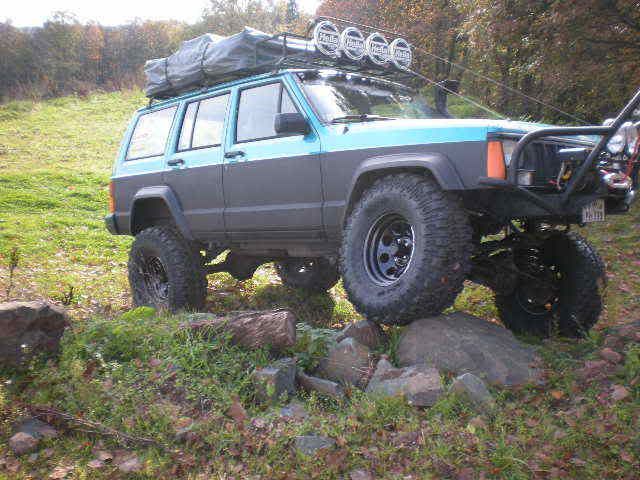

Looking good. Breaking up all of the teal looks much better.
I see your TrXus took a bunch of weight to balance. Mine too. I'm hoping that won't be an issue down the road.
You build some wild vehicles. Hope you get out to enjoy it soon.

You should never need more than 1.75 ounces to balance a tire and it looks like you may have close to 4 ounce of weight there. I suspect that the heavy side of the tire and the heavy side of the rim are matched up. That typ of weight on your rim will reduce your tires life over time and could fall off and be vary hazardous. If you were to bump one loose on a trail then at highway speeds could come loose and you are looking at 1.75 ounce bullet.
Have them break the beads and rotate the tire 180 degrees around.
I worked at a specialty tire shop for many years and we did this all of the time. We have pulled weights out of fenders before.
Just a thought.

Carman, you are right, and thats the reason I want to go with Dyna beads. I mounted these my self (mechanic for almost 10 years), and broke the bead and rotated the tires multiple times to get the best balance possible by finding the heavy side. They are just hard tires to balance, some were beter than others. Before I bought these I did a lot of searching, and that was one of the biggest complaints... so I knew going in they would be tough.

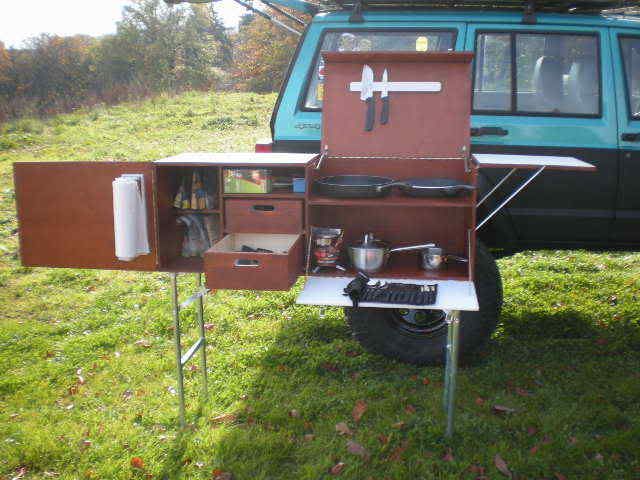

Here a few shots for the day.

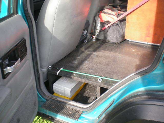

I got these awesome removable tie downs for my kitchen on the rear platform. They are really slick little gadgets, and work flawlessly. The bolts they came were long enough to go through the wood, and all through the unibody, so they are mounted very solidly. They are rated for 4000 lb vertical pull, so it should hold my 45 pound kitchen just fine...
This is how the kitchen fits in the Jeep. I put it in and pulled it out a few times by myself to get the hang of it, and its pretty simple. I slide it out to the edge of the bumper, fold down the outside legs, then fold down the legs on th bumper side. Then its easily movable as a stand up unit, even by myself.
All strapped in. The little 4 drawer craftsman tool box is bolted to the floor with (4) 1/4-20 bolts. I have learned my lesson the hard way in the past by not having tools onboard when you need them. Now that I have a Jeep, I am sure to bring them with me 24-7 :)

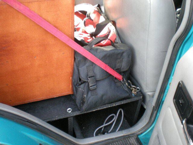

The orangish duffle bag holds all of the straps, shackles, bungees, and hi lift accesories. They are really heavy duty bags, and hold the weight and bulk with no problem. The little black bag is my MV50 compressor. You can also see the front tie down for the kitchen.

I can have the kitchen set-up and ready to cook in about 1 minute and 40 seconds by myself, including the unstrapping. If I have someone with me, it can easily be done in under a minute. mission accomplished. :)

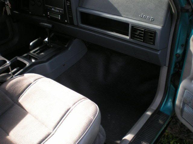

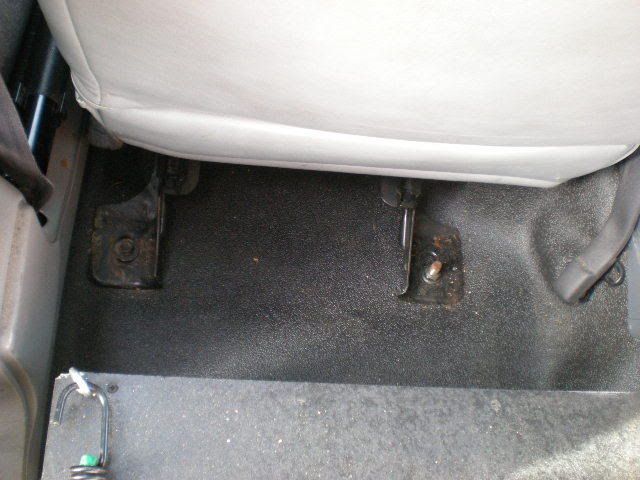

Couple interior shots for John. The sunlight was kind of funky, so the pics arent that great...

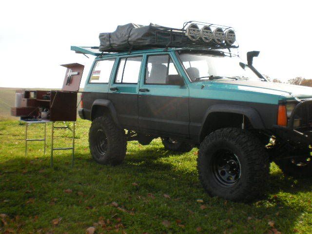

And finally a couple poser flex shots at the future campsite.

The floor liner does look like it's self molding better with time, the floorboards under dash will probably get even better once you start using the heater more. I may follow your lead with this product.

Honestly I am quite pleased with the vinyl flooring. It was very misleading on what I was actually getting, and was a pain in the ******** to install, but the outcome has been 100% what I wanted from a vinyl floor. The best part about it is I can spray it with simple green, and wipe it out with a towel and it looks like brand new. I hadnt cleaned this stuff since I installed, and today I did just that. It looks new, and it was full of mud and crap as our fall weather (read: RAIN) has been set-in for the past few weeks. I highly recommend doing it, just be prepared for what I mentioned.
In the pictures its kind of hard to tell because the floors are shiny after I cleaned them and the reflection/glare makes the ripples that are still present much bigger than they actually are. It has laid down quite nicely.
