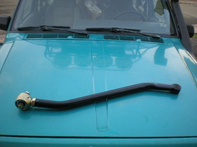

Installed the track bar and set the track as close as possible using the "overlandXJ method" (thanks John, worked like a champ!)

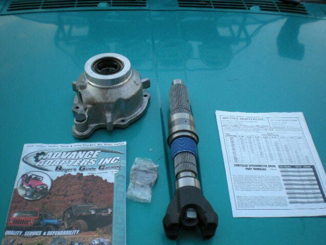

Today: Installed the Advanced Adapters SYE kit. This wasnt too bad honsetly. Looking at the instructions and reading the nightmares from other people doing them, I was a little concerned. It all worked out fairly well. A messy job, but MUCH easier now that my Jeep is a WHOLE lot higher! :) Its nice to be able to drain your engine oil into a 5 gallon bucket without using a jack...

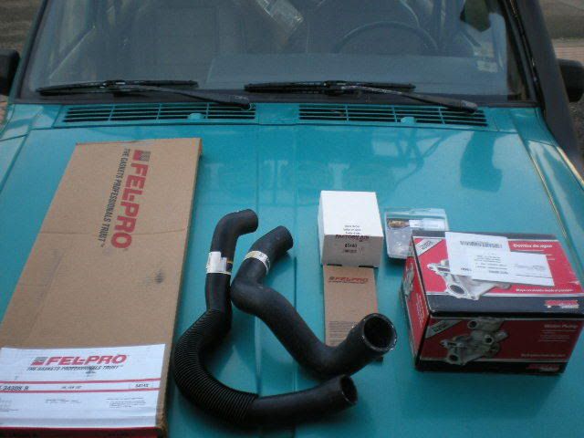

The day before I started the suspension, my water pump crapped out on me. Not exactly an un-common thing on XJ's and I was kind of expecting it any time because of the mileage and known weakness. So, I ordered a new water pump, new thermostat and thermostat housing, new upper and lower radiator hoses, and a new 3 core aluminum radiator. I got everything in so far except the radiator. This stuff will be installed in the next couple of weeks. While I was ordering those parts, I ordered an oil pan gasket, and new rear main seal set, since mine is leaking. I will replace this stuff one weekend in the next couple of months.

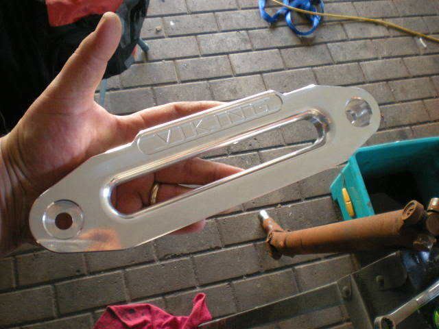

When Vince was here, I got extremely jealous of his synthetic winch line, so I ordered one of those as well (its his fault). 100 feet of red amsteel blue sythentic winch line from viking offroad/winchline.com to replace my kinked up, skin shredding old steel cable.
Of course, I needed a new hawse fairlead since my old roller fairlead was chewed up from the steel cable, so I placed an order with our friends at Sierra Expeditions and got this, along with some cool new SE stickers. (Thanks Wendy!)
