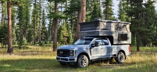

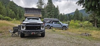

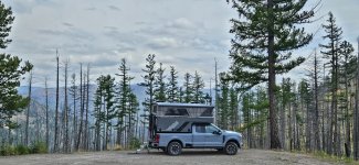

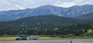

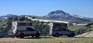

Images from trips over the last month.
First two images are of an ATV trip to nearby mountain range in mid-July (left a day early due to black flies and record heat).
Couple night trip to a different nearby mountain range in late July. Drove the mountain roads for two days.

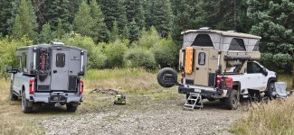

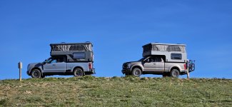

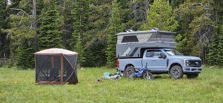

Early August ATV day trip.

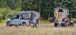

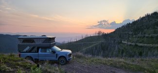

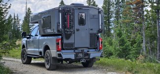

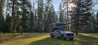

Last weekend, few-day trip to a different mountain range amongst the huge Tamaracks. Camp the morning after the first night.
Lunch break on day two. Drove the mountain roads for three days.
Camp spot for the second night. Waiting for Northern Lights (that never materialized) though that was not the reason for the trip.
