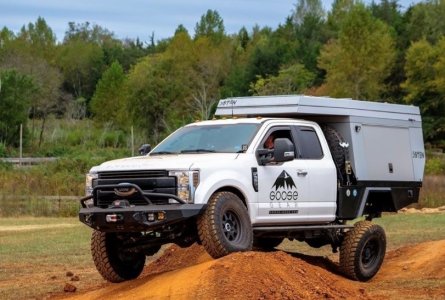

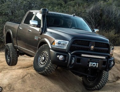

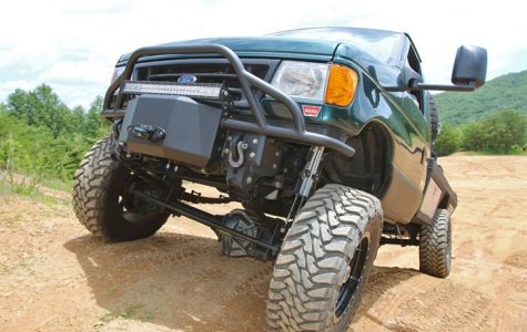

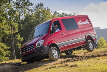

Some snapshots are fun to look at for this Sprinter vs E-Series vs F-Series (or other full size trucks--yes, I know the RAM is lifting a rear tire), but videos are much much better to get a more accurate perspective.
