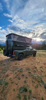

Adding image from an owner that chose dark grey cushions for their build and said I could share.
Another owner offered to share images of their dark grey cushions.
Hannah and Wesley ( @thisistheway_adventures on instagram) have this color-matched build and gave permission to post some images of their rig.
They asked me to tag @mtnyotas as well, who helped with the build. It's mounted on the newest generation of the Toyota Tundra.

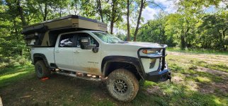

Brilliant write up - up to date and more! Thanks @chadx ! We are #5 and have added some goodies to the rig along the way which I will show in another post. We are on a 2016 Ram 3500 crew - with Flat XP Tray and Custom @bowens Boxes (before his super tray came out). We really pushed ST to instal the largest Tern Overland window possible, a door window and the new Truma combi eco- plus (for propane and 110v) heating and water... which ST made happen without a blink! - i believe we were the first. More photos later. Our truck on IG @wanderinglyle - great work!!!
