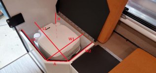

Has any person successfully placed a CompoCloset Cuddy or Cuddy Lite toilet in the LT shower well area? The spec on the toilet height is 16.3”. Trying to make the decision on the throne to take advantage of the BF sales.

The toilet/shower basin spec is likely somewhere in the thread, but I'll measure and post when I get home.
But I'll share that a Trelino brand separating toilet in size L is 16.9" tall and it does not fit (too tall). Size M is 14.2" and fits but sits rather low so most put a spacer underneath (teak or bamboo shower mat) to raise it closer to the cabinet wall height. Will post pan measurements in a couple hours.

@twowheels19 Unfortunately, I don't think a 16.3" high toilet will fit. And the 17" length may also be an issue.
Went out and measured. The below image I took of a demo flagship back in summer 2023 (we did not get a portable toilet when we bought ours), but in a previous conversation, I used it to draw some dimension lines.
Height: 16" to 16 1/8" depending on where you measure.
L1: 23 1/4"
L2: 18" (not exact because the bend on the 45 degree section is a radius and not an angle)
W1: 16 5/8"
W2: 12" (not exact because the bend on the 45 degree section is a radius and not an angle)
The stock portable toilets (like pictured) have to sit sideways, but they can be used sitting sideways. Most separating toilets, like our Trelino, can not be used sitting sideways because things "don't line up", but luckily, many brands fit facing front to back.
I've noticed a lot of these small separating toilet manufacturers incorrectly call their products "Composting toilets" rather than "Separating toilets". Even the very large volume "composting toilets" with agitators fill up and need to be emptied long before any composting can take place. When they are cleaned/dumped, the solid bin content can be added to a dedicated compost pile where composting will take place over the following year. But contents should never just be spread on top of ground and left (should go with out saying, but some may get the incorrect impression that it can be spread anywhere since it's "compost". Even those big "composting" toilet need to be bagged and thrown in trash when on the road and not spread randomly, no matter how remote.
These smaller versions have even less hope of any composting occurring. It seems to be more a marketing phrase. Even if one used the toilet for a couple days worth of solids, added media and left it sit for a few months, no composting would occur. The media's job is to dry out the exterior of the solid, which greatly reduces odor, but it effectively mummifies the solids so no break down will occur. Think of exposed animal dropping that dries out on the exterior vs what happens when stepped on and the dry exterior makes way for not-so-dry interior.
Separating toilets can be used multiple times, for solids, by using drying media to encapsulate and dry the solids. They work much better if the paper is not added to the solids bin and are instead thrown in a separate trach bag. We've noticed that driving down bumpy trails means solids do not stay buried in the media, so while it's reasonable to use the same back and layer media while at a single camp spot, it works best to remove bag before driving.
We use our separating toilet regularly for liquids, but still prioritize using bathrooms, outhouses or digging cat holes if allowed (and weather/bugs permit). The separating toilet is our last option for solids, but it's very nice to have available. We use media, but we bag it before driving and have a dedicated dry bag, for the bagged-up solids to go into, which seals in scents completely (which is not the case if the bags are thrown into a non-sealed trash sack like a trasheroo or similar hanging on the back of the rig.
L1: 23 1/4"
W1: 16 5/8"
Based on measurements, the Cuddy Lite height does seem problematic. Fortunately there is some flex in the lid, so it does just fit. The aluminum bench cover rubs on the lid, so we added a towel on top, but even with that and a pad under the toilet to prevent shifting and scuffing, the bench lid closes.
We're the opposite of Mr. and Mrs. Chadx, and have yet to uses the toilet for liquids, which go on local vegetation. We do prefer it to cat holes for solids, even in 20s F weather. The plastic warms up pretty quick. We include the toilet paper for convenience, and remove the bag daily and keep it with other bagged trash in a collapsible bucket in a Roam box mounted on the back of the camper. With regular trash stops, no issues with odor, so I haven't had to dedicate a dry bag to storage, although that's a good suggestion.
As @Chadx notes, small "composting" toilets do not do any composting. And you wouldn't want to try to compost solids anyway, without the industrial scale that sludge is composted at. Even if you could get it hot enough for long enough to kill pathogens, the solids still contain heavy metals and toxic chemicals that come from eating at the top of the food chain. Best to just put in a landfill like disposable baby diapers.
Here are a few shots of the Cuddy Lite to demonstrate the fit. It does need to be taken out of the shower enclosure to have the geometry right for use. In campsites with traffic or cold/wet weather, we put it in the outdoor shower enclosure. When we have an area to ourselves, we enjoy a "loo with a view," something I learned to appreciate with groover placement on river trips.
