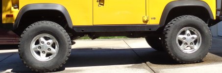

Just how much the wheelbase has changed at the new ride height is what I was curious about. So I pulled out the tape measure straight edge and a bubble level and did my best to accurately measure the wheelbase of my lifted NAS D90.
Stock height the wheelbase is supposed to be 92.9"
I'm running an old school SG Stage III kit, with stock radius arms and stock length aftermarket trailing arms..
Looks like I'm at 92" This doesn't seem like that much change, but it is visibly noticeable:
So how much benefit is their in returning the wheelbase through the use of lengthened radius and/or trailing arms (and possibly an a-arm extension in the rear)?
Of course the front axle also shifts to the Drivers side, thanks to the same phenomenon with the panhard rod, but in a different axis. This I didn't attempt to measure..
Of course lengthening these arms also means the wheelbase extends (more than stock) when the suspension compresses. Is their room for this or will tires be more likely to have body interference? And will driveshafts run out of usable extension travel at the spline (this also affects pinion angle on the driveshafts, I know)?
Thoughts?
Sounds like a lot of mucking wrong for 0.9”! Plus your shorter wheelbase will allow you to go over steeper bumps without bottoming out like the 1” longer one (in theory anyway)

waste money fixing nothing with custom adjustable links if it's bugging you. you can dial that 1/2" per axle right back in.

It will shorten a minimal amount if its a system that has radius arms. Do the geometry. I'd be more concerned about caster and ride quality.
It is a result of the frame going up, not the axles. This moves the radius arms and trailiing arms up and at a steeper angle unless they are also lengthened.
