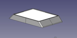

Here's how I mounted our Starlink mini dish to our Tacoma. There are lots of mounts available on Etsy but I figured there's no point in having a 3D printer if I don't use it. And I didn't see anything that was quite what I would make myself: streamlined with integrated magnetic mounts.
So rather than something like this:
upload_2024-9-11_23-0-59-png.5840759
Or this
or this
I was thinking about something like this:
The base for the dish would look this this before the dish is installed.
And the bottom would have integrated magnets:
Using these magnets:
upload_2024-9-11_23-12-51-png.5840763
I'm still working out the details of how I will power directly from my Tacoma. But for now I'm using an Anker Power Station until I have it hardwired to my Tacoma.
I tested the dish and the WiFi signal is great from the inside of the cab when the dish is mounted on the roof of the cab. And my canoe does not interfere with the signal.
Here's the finished install.

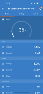

We just got back from our Spring Break desert trip and one take away from that awesome journey was that our 8 year old solar panel just wasn't performing like it used to.
So I'm trying a new panel that has twice the power at 100W.
Like my old panel, I'm using adhesive magnetic strips. One thing I've learned from using these magnetic strips is that over time they will bond to the hood permanently. So it is important to remove the panel periodically and not leave it on the hood for months on end.
Because the panel is larger, I ran several rows of magnets on the leading edge.
Also upgraded to MC4 connectors for the panel.
Always taking the extra time to use split conduit tube and automotive wire harness tape.
The panel fits great but I don't like the white boarder of the panel. The eyelets also prevented me from running the magnetic strip all the way to the corners. The new panel is also a plastic sheet rather than aluminum. But ultimately either it will stay on the hood and generate electricity or it won't. That is the test.
Most important is that it is producing more than 2x power. Here is a screenshot of my Victron solar charge controller. At 5:18 PM the sun is at about a 30° angle.
