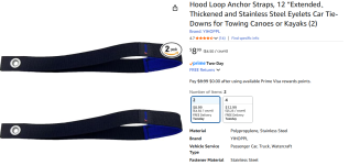

My wife has been asking for this for a while now. We use the truck bed as a sleeping platform and she cannot close the tailgate because it weights more than she does. So the idea was to add some straps to pull the tailgate closed.
I got these on Amazon
The tailgate screws didn't fit in the eyelet.
But that was nothing that a littler persuasion couldn't fix
I mount the straps on the ends so they would be out of the way. I have them angled inward just a bit so they don't block the tailgate latch

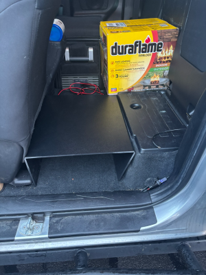

Last week I did a long overdue rear seat delete in my access cab. What I noticed about how people approach the seat delete is the Law of the Instrument in full display. Welder's build with steel, carpenters use wood, people with money buy kits from Cali Raised or Goose Gear. I live a mile from Tap Plastics. So, I went with 1/4" ABS sheet.

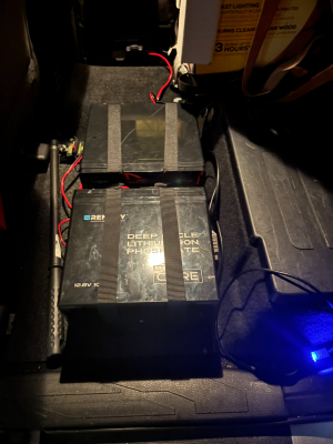

More important was what got installed under the ABS shelf: 200AH of LiFePO4 batteries charged by 2 100W solar panels/Victron Energy SmartSolar MPPT Solar Charge Controller and a Victron Energy Orion-Tr Smart DC to DC Charger for when the engine is running.
Which is also my ice cooler delete, since this all powers my new Dometic CFX5 25 fridge which now lives behind the passenger seat.
I put my old storage drawer on top of the ABS shelf.

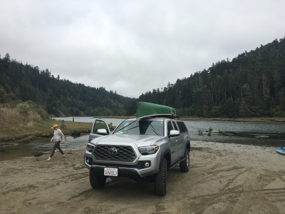

Wanted to ask you since the first page, what are you tying the front of the canoe to underhood? And what are you trying it down with?
I've got a Leer cap with a Trac Rac "CapRac" on my Sierra and have a Pelican Colorado canoe that sits rearward when centered on the rack, as yours seems to do. The kayaks without the canoe are fine, but the canoe is longer

I run a single piece of 1 inch webbing that is 12 feet long in a loop from the bow of the canoe to under the driver's side hood hinge then under the hood to the passenger side hinge and then back to the buckle at the bow of the canoe. So, the webbing forms a triangle with the top (buckle) at the tip of the bow of the canoe and the webbing running horizontally from one hinge to the other under the hood. When I close the hood, it tightens the webbing just enough to pull the bow of the canoe down and inch and I can pluck the webbing and make a "thong" sound.
