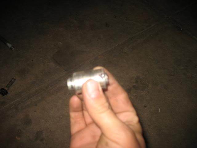

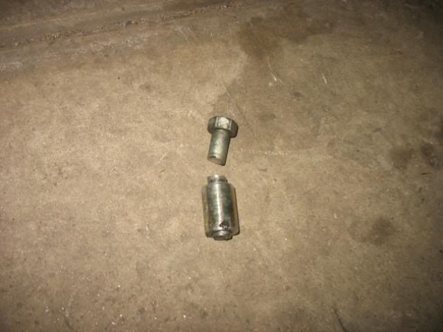

I had to cut one of the rack and pinion bolts off because I got in a hurry when the body was off and drove the bolt in the sleeve. OOPS! there was no way out but to cut it, also destroying the polyurethane bushings another $22 for a new rack and pinion kit and we're in business.
The bolt.

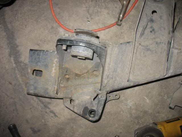

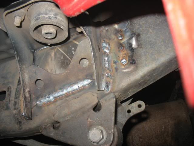

Then I got the frame ready for the body mounts.
The procedure here was:
Cut mounts off of trashed frame, clean them up, bolt to body, set body with mounts on the frame (adjust height as needed), tack in place, remove bolt and jack up body, Burn metal, paint and bolt down.
It took most of the day to get to this point but it's done.

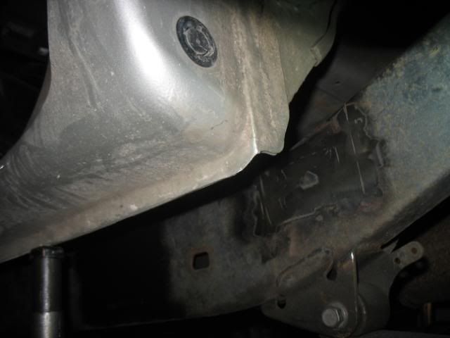

The mount on the old frame.
