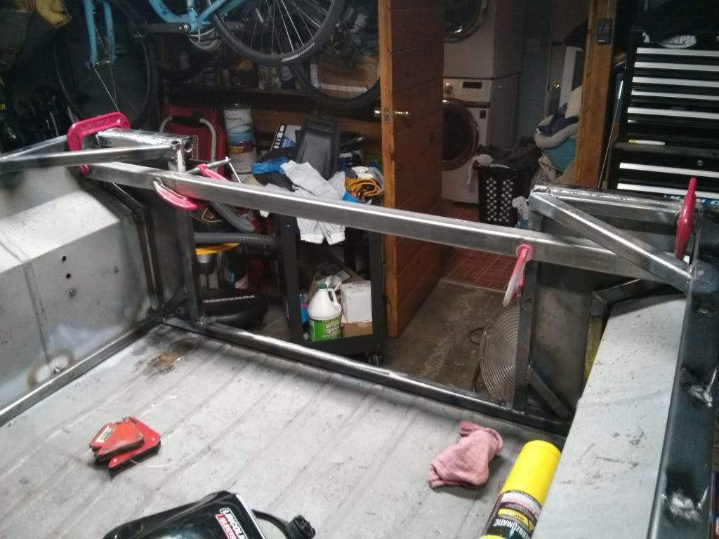

So I have a pretty big update that will help out alot of people with these old beat up m416 tubs, now I know most of you have tried to straighten the tub sides out by using angle iron but all that is really accomplishing is Covering over the bent side.
So my solution is first go to harbor freight and purchase 2 of the largest "F" style aluminum bar clamp (roughly 48" wide) they cost about $14.99 each. Then put then stretched side to side and crank them down to straighten the sides. Then use a MAP torch and slowly heat up the whole side of the side (1 side at a time) starting from the center out. Once you get the whole rail piping hot just let it sit and naturally cool down (4 hours at least) and presto a straight side!!!!
Worked great for me, I just did one side tonight and when I released the clamp it was straight as a arrow. So I'll give the other side the same treatment tomorrow

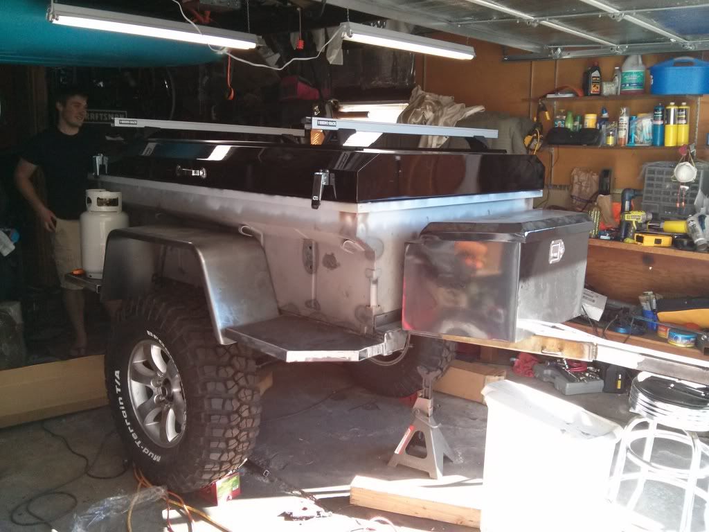

I wanted to pit the lid on to see how it lines up with the c channel I made for the top lip. It took awhile to straighten out the top lip but I was able to get it really straight. And the c channel turned out excellent to clean up the top edge.
I then drilled holes every 6 inches to put in a spot weld to hold the lip to the old tub. I think I'll also put in some welds every 6 inches or so on the inside to further secure the top lip.
I also finished up the rear tailgate opening and I think I have it gussetted pretty well but I'm wondering if maybe I should add a inside gusset to resist a widening when the top is opening. I'm going to put some more thought into it. Its really rigid as it is now and the opening for the tailgate is perfectly square with exact measurements all the way around.
Here is a few pics
I ordered my new suspension parts from summit and they should be arriving in Tuesday. I started bolting the trailer back together using new grade 8 hardware. Wanted to check for ride heights and axle measurements so I chocked the wheels up. Ill finish all my measuring tomorrow and place my axle order on Monday
