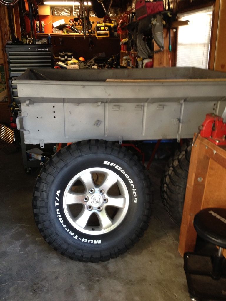

Thanks for all the part numbers! I decided that I'm just going to get a new axle with electric brakes. I'm not sure if I should keep the same width or go a little bit wider on the axle, any thoughts? I plan on running 35"s with 6 lugs and Toyota wheels.

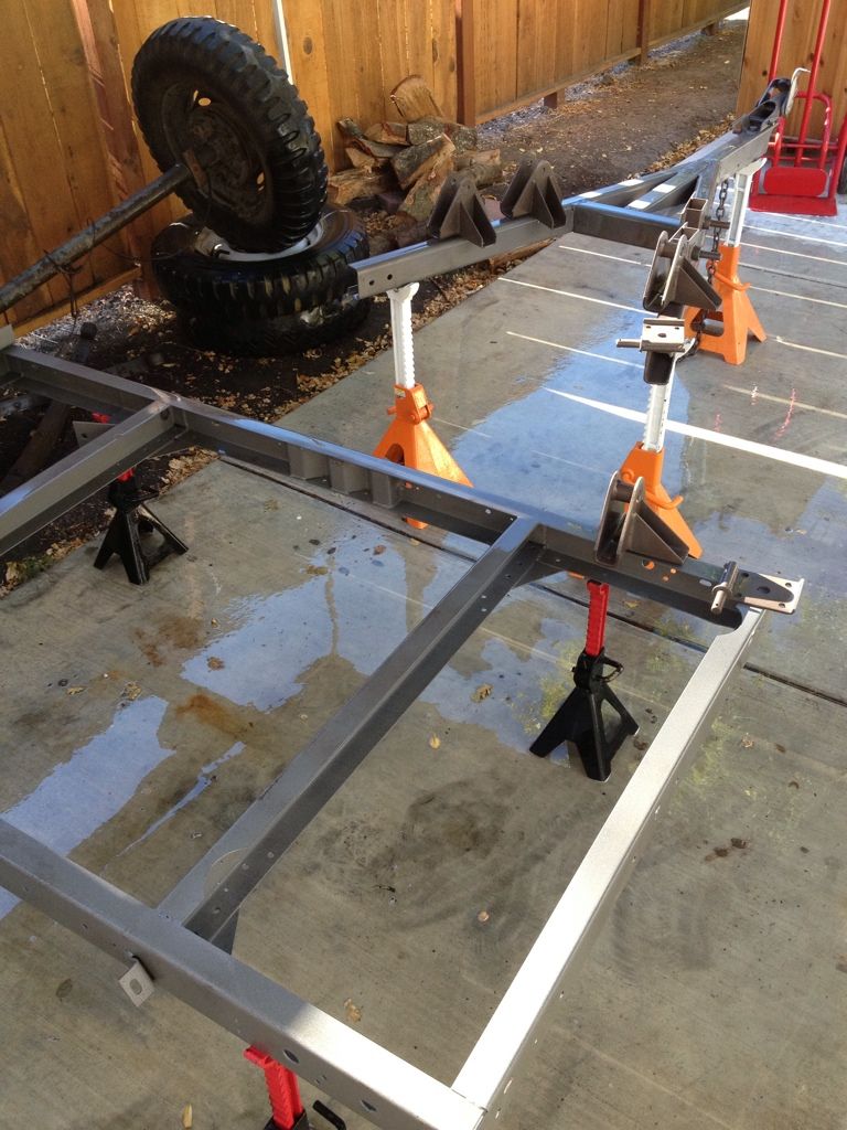

I spent 2 hours this evening stripping everything down so I can get everything sand blasted tomorrow
Picked up my trailer from the sandblaster today and put it in the garage away from the elements, here it'll stay til next Monday when my shipment of POR15 arrives and my order of body work hammers and dollies

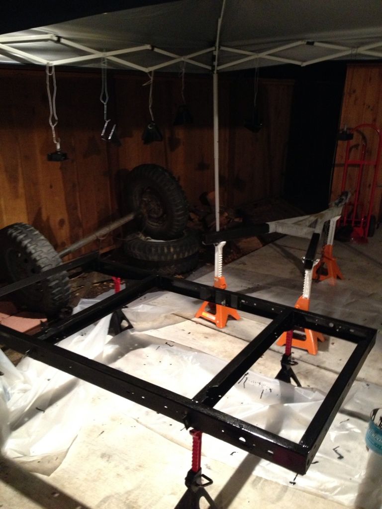

i just started painting on the POR15 today first i prepped with marine clean and then metal ready
now i have the first coat down waiting for it to dry

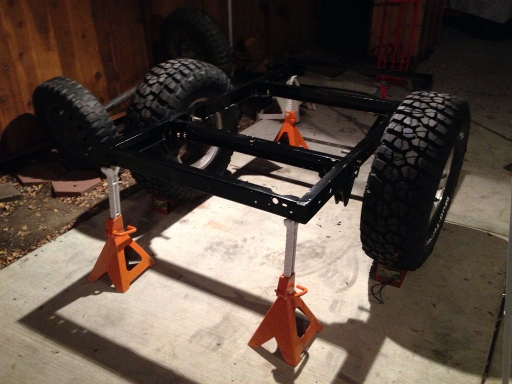

I ordered my new suspension parts from summit and they should be arriving in Tuesday. I started bolting the trailer back together using new grade 8 hardware. Wanted to check for ride heights and axle measurements so I chocked the wheels up. Ill finish all my measuring tomorrow and place my axle order on Monday
