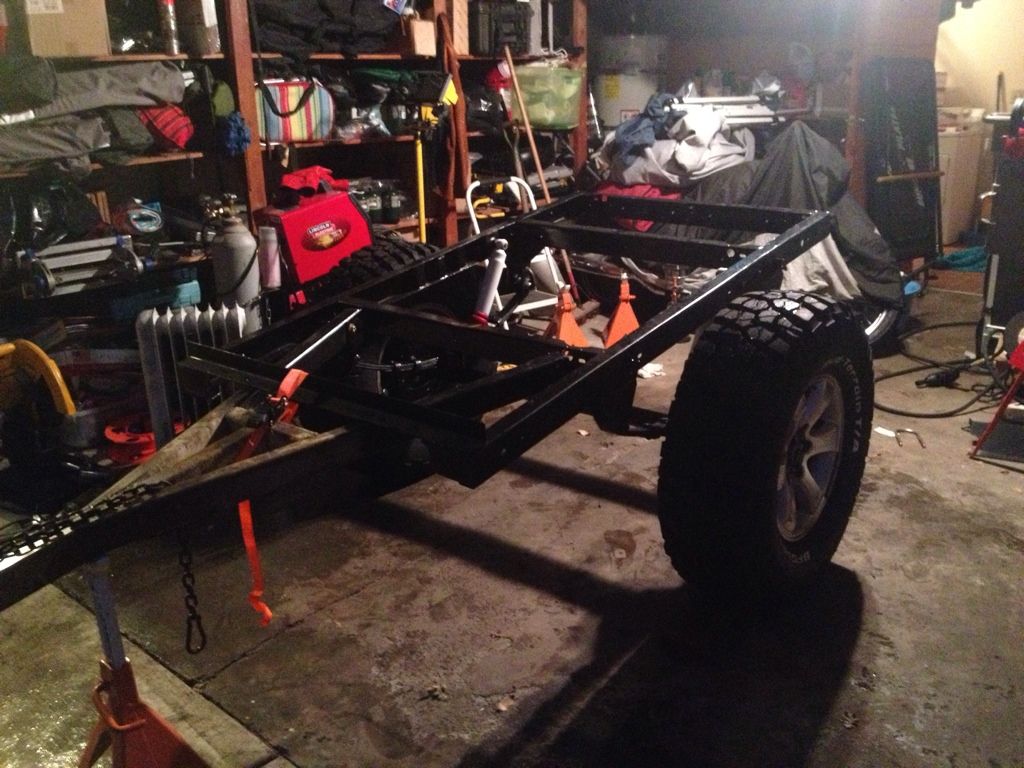

Completed some work on my trailer yesterday.
Welded up the spring perches on the axle then installed the electric brake hubs on the axle. Had to make a run to a trailer supply store because Summit Racing didn't send me the proper u bolts (3 were correct and identical and the 4th was way larger than the other)
Then after that the tongue took some work to get back into the frame, the tolerances were so close we had to use a ratchet strap to crank the tongue into the perches.
After that we installed the spider trax spacers then installed the wheels and then flipped the axle onto its own weight.
On thing I need to switch out the rancho 9000 shocks. I purchased a set that were made for a cj 3 but with the springs at full droop the shocks are pretty much completly compressed so they need to go

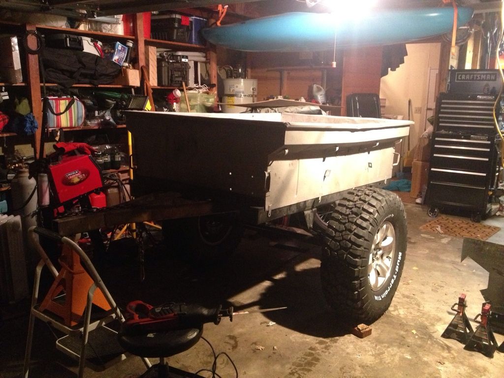

Next we bolted on the tub to start on the body work so once I start welding it will hold its shape. Ill probably start off on patching all the holes
But that's enough for the weekend :)

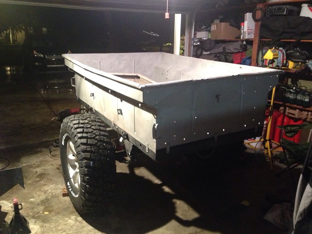

my trailer is quite a ways from done but i thought i would mock it up and attach it to the trailer and see how it fits up and looks...
well i think it looks amazing!
i still have some body work to do then frame out the inside and top rail then cut in a tailgate. then wire up all the electrical and brakes but for now i just mocked up the new fenders and lid to get a idea how it is coming together. the frame sits at 30" from the ground which may seem high but its just a couple inches higher that the 4runner frame and it will come down a bit once weighed down with all the gear
so here is a bunch of pics
and lastly the axle for good measure

Are you going to color match the tub with the toyota?
Wheels too or get matching?
I like the yellow build marks on the hitch bolts to see if the loosen.
Great build, I like the extended tongue just the right length.
Can't wit to see the finished product.
