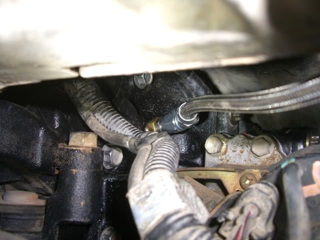

Also cutting air lines
If you were to cut a line to your front diff you would have worse things to worry about.
...it's kind of out of the way. Oh, and Stainless lines are hard to cut.;)
