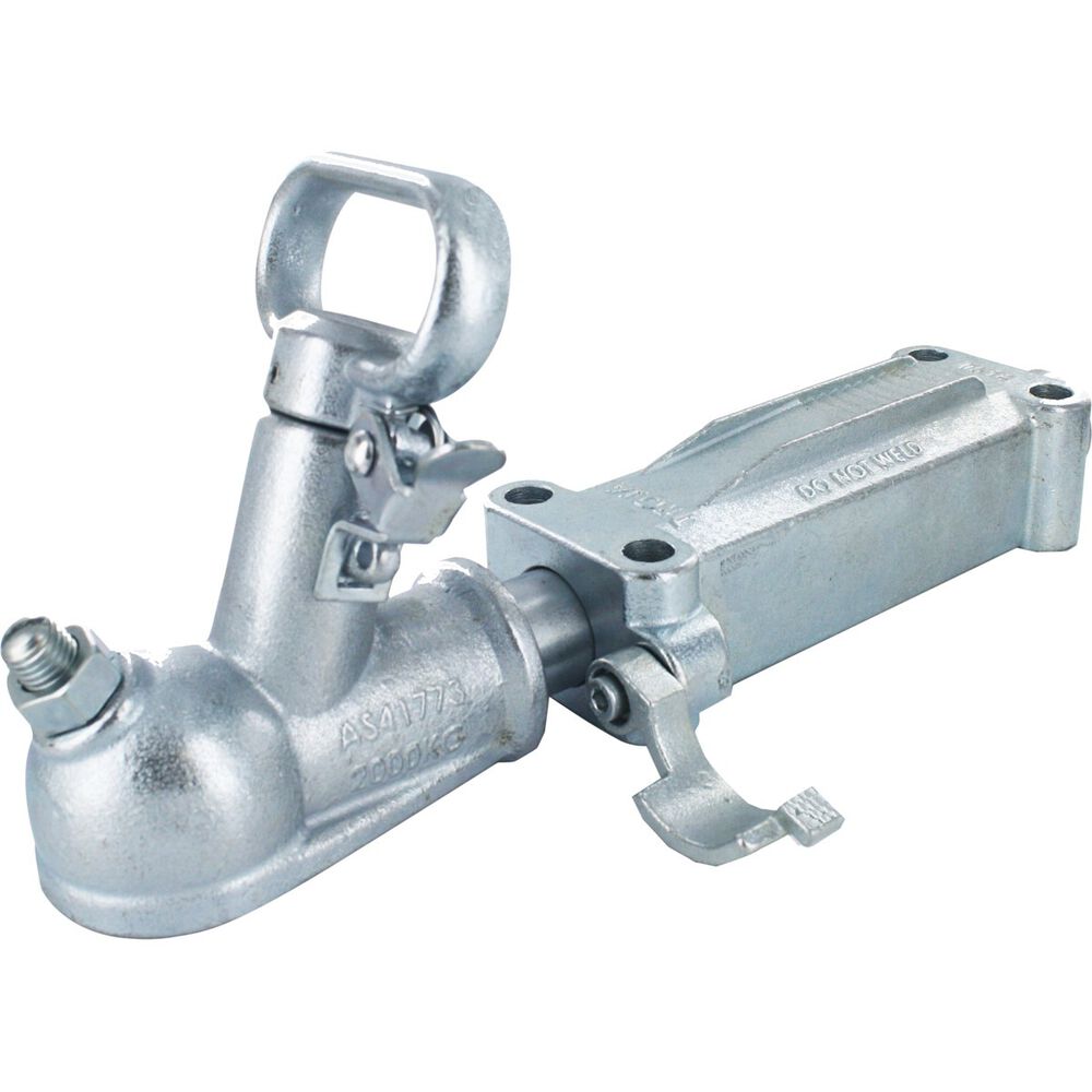

I keep forgetting that in most cases the US spec 50mm/2" hitch is a bolt on job with no movement; in Australia and the UK, they all tend to have some rotation on them like this:
where they have some rotation on them, based on the section that activates the manual override brakes. In my case, my trailer runs with the collar over, and I use electric brakes. In the UK, override brakes are the norm.
UK hitches are different again... and there's a huge range when you head to the specialists like this mob:
