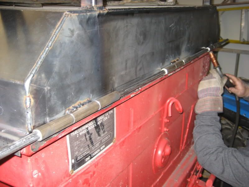

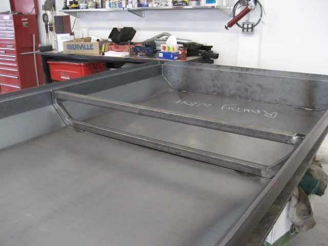

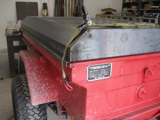

one piece 14 gauge ends are thicker notice how the edges are folded over the edge of the trailer.. piano hinge home made with some stainless bar and some tubing, racks welded to the top tent bolted to the racks

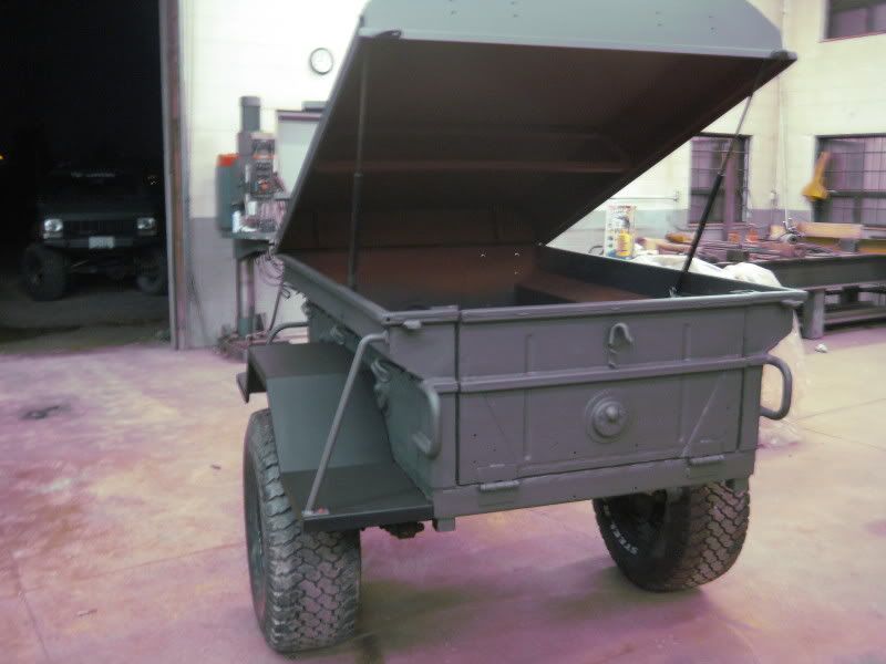

Nice job on the lid. Similiar to what I have in mind. I was going to make mine open from the side. I also wanted the extra lip at the bottom, but was planning on putting it on the inside. Your idea might be better for keeping dust/water out.

yes my lid is mounted on he end..with the tailgate cut in, i feel that it is much stronger that way.. as far as openong it up as you can see from the pics. once camp is set up if i need to get in there i can still get anything i need thru the tailgate quite easily .. some things you gotta strech for but it really is no problem at all
