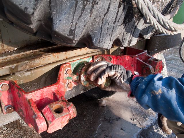

I was out at my friends house today whom has the PTO trailer I am looking at buying and rebuilding. It was really quite interesting!
For starters the frame and axel it is built on is the same as my truck, the Laplander. So the trailer's rear axel and it's gear ratios are the same as the trucks. The brakes work on a kind of hydraulics which get their power from a converter from the trucks braking system. I am guessing that the trailer is a 3/4 ton. Too heavy to even consider maybe?!:Wow1:

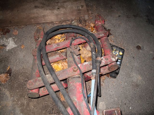

Here you see two red attachment blocks which connect to the trailer. In between them is a pin like thing sticking out. this is the covered PTO shaft.

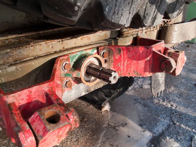

Here Mårten is unscrewing the cap to expose the PTO shaft.
The exposed shaft.

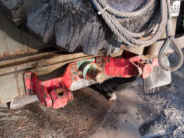

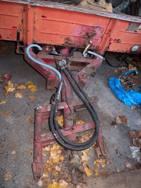

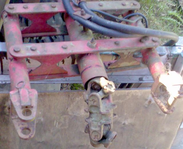

Here you see the trailer's driveshaft in the middle which slides onto the PTO driveshaft that exists the rear bumper. The two attachments on either side connect then to the two red attachment blocks on the bumper.
The two side arms as we see here swing in the direction of the vehicles turn. The both swing and tilt fully as not to hinder the trucks turning radius.
The yellow part is the for attaching the axel from the power outlet from the transmission (is it called this?) to the rear PTO.

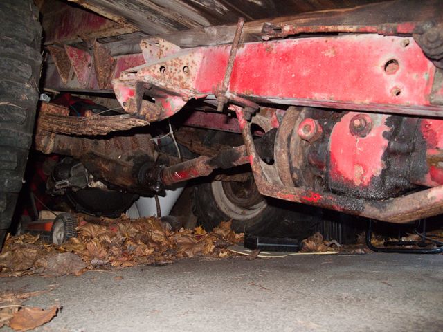

Underside of the PTO trailer.

From the looks of that yellow PTO output flange, its likely 1:1 with the output of the tranny, which might work if your hi-range is 1:1 in the T-case, but it won't work with a reduction at the T-case. I'm basing my experience off of a Land Cruiser PTO setup in which the take-off can be 1:1 with the output of the trans (in a near identical configuration). It would not work for a trailer drive unless the trailer had some sort of a t-case that could also be dropped into a low range to match that of the vehicles. The trailer in your pics seems to have just that?

In looking at the trailer pics it would appear that it employs a Dana type axle. I'm guessing a 44 series from the looks of it.
