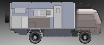

Free comment: Don't hang your spare tire on the back. Extend the box and put the spare inside. Your overall length will be the same and you can avoid all the weight of reinforcing the back wall and mounting a winch or similar. Likewise bicycles, etc. - put 'em all inside. The extra panel length is cheap compared to the alternatives. Also much better theft and weather protection.
Yes it's certainly a valid suggestion, I think you mentioned that a little while back. I plan to stick to a rear mounted wheel for the following reasons.
I am already maxing out the length of the body in terms of overhangs, and the logistics of getting a wheel in and out of a garage is much more than lifting it onto the back. The bed would have to be very high or I would need a false wall internally. Or laying the tire flat would be hugely challenging. Strapping it down securely would also be more of a challenge.
And whilst the vehicle length is the same, the sweep when turning is not as the wheel tucks in.
The fabrication and design of a rear mount is not a concern for me, and having that frame out the back also helps protect the soft fiberglass body.
But I do appreciate the input, and for some it may be a great option.
Actually, internal mounting is much easier and lighter and length is length. Less weight and lower. (Actually, you want the spare up front, as the military do it, but that might interfere with a pass through.
But it is your truck and your money. I have a rear mount and know what I would do if doing it again.
Have a great build.

I'd be interested to know the details of how you would do it again? How would you load/unload the wheel? Ours will be approximately 42" tall and 300lbs.
Yes unfortunately there isn't room between cab and box, it's too narrow and there's a lot going on there. Hydraulic tank for winch, pass through, probably ac outside unit and possibly a light tower.
The truck as it was when purchased, empty, already had 4000kg on the front axle, with a limit of 4800kg if memory serves. And 4500 on the rear axle. So I need to be careful not to overload the front axle, especially with my increased wheelbase. So weight at the back is helpful in achieving this, though I want that weight at low as possible naturally.
A balancing game, if you will...
