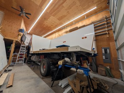

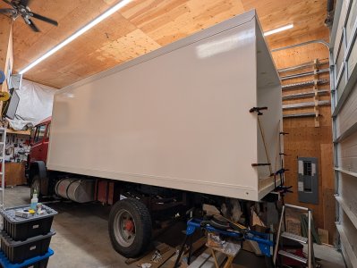

Well that has been quite the weekend. The box is glued together! And it came together even better than I expected, what a relief. Everything is square, true, plumb to within 2mm, as best I can measure. Seems like plenty good enough. Celebratory charcuterie board was just leftover's from someone else's party haha.
I will say that I understand now why Total Composites moved away from suppling kits direct to DIYers (although rumour has it that may start again....). There are so many ways to do it wrong, and it's very hard to get everything right. The learning curve is very steep no matter how many times you've watched the helpful youtube videos. It takes a methodical approach, a handful of helpers and a fair bit of time and a lot of caution. There is lots of slow prep, then as soon as the glue leaves the tube the clock is ticking and it's suddenly a rush.
Getting the right amount of glue, but not too much so it's hard to clean up, was the hardest thing to get the hang of. Especially when you're upside down, or hanging onto a ladder. But leaning towards too much, and being ready to clean up quickly, it wasn't too bad. Each profile needs a different "dose" but you figure that out pretty quick.
The other major challenge was order of operations. The way I positioned the truck and the way the panels were loaded onto the racking worked out really well. When it came to the ceiling panel, the only way to do it was to lift it onto the floor, stand it on saw horses, glue on the extrusions and then lift and rest it up out the way on top of the front wall and one side wall along with a janky looking vertical support. It was a little sketchy and fairly heavy... but it's not stupid if it works. After the other side wall was glued on, then the ceiling extrusions had glue applied and it was dropped into place. Luckily it fell right on, the measurements had been correct.
I 3D printed a set of five sanding blocks with wording on them to allocate them to each place they should be used. With many different flange lengths on the pultrusion profiles it was important to only sand where the adhesive would be, and no more than that.
After Friday and Saturday the floor extrusions and two walls were in place.
We got the ceiling balanced up high...The foam blocks pinned down into the wall panels. Just about stable.
And now here it stands!
